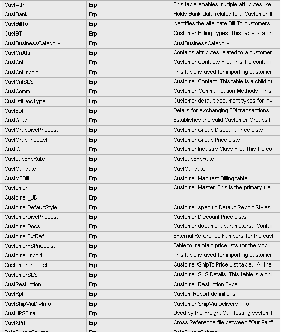

@josecgomez - How did you handle this? We’re considering opening up BAQ to let someone do their own analysis, and need to restrict access to hundreds of tables related to $ and customers… I didn’t see a DMT for Field Security either, and really don’t want to do this manually one table at a time…
Just to start, for letter C’s:

Great! That would be very helpful. Which table is it? I’m not following the bindings shown in field help - Seems to be DBField, but I don’t see that table in BAQ…
