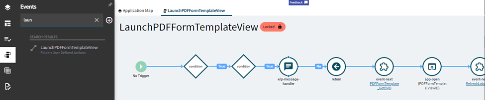

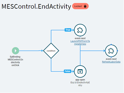

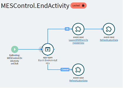

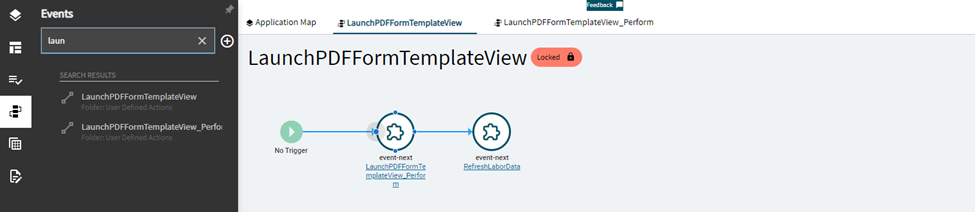

Epicor modified the “LaunchPDFFormTemplateView” events as described in my initial case filing, but I had initially thought they had forgotten the first condition in their redesign of that event. But what I found was that they ALSO modified the EndActivity button click event
2023.2
2024.1
The condition in the new 2024.1 MESControl.EndActivity is the same condition that USED to be in the LaunchPDFFormTemplateView event.
Because I was using a custom event it did not contain the “moved” condition.
