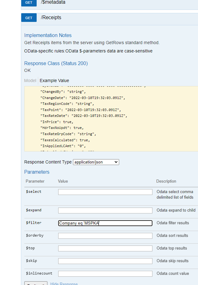

I can run a wide open GET, but cant filter to the company in issue

All the GET requests I’ve tried work, unless I try to throw a filter. then I’m back to 500 land.

What do you mean you cannot filter?

Swagger.
You should not be getting results from multiple companies as far as I know, so filtering on the Company field doesn’t do anything.

The affected one no, if I filter to the company acting up, I get the 500
