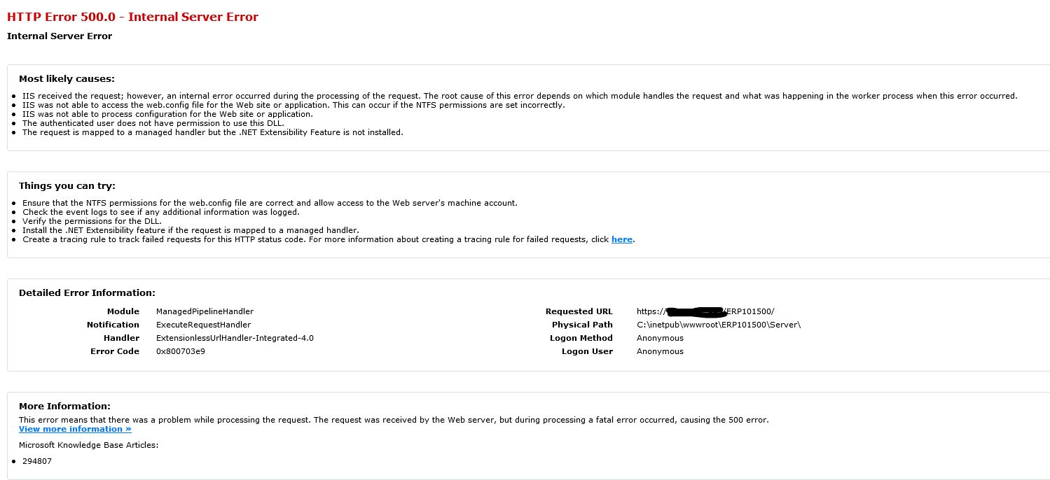

Trying to set up REST. IF I use https://my server name, no error. If I use https://my server name/ERP101500, gives me an HTTP Error 500.0
Well, I got it to work till servername/ERP101500, but when I add the /api gives me the error, HTTP Error 404.0 Not Found
look here 404 Error when testing REST Implementation - #5 by DCurran - ERP 10 - Epicor User Help Forum
Thanks! So it is the Web.config that is messed up. To be honest, I am not sure what to look for to fix this.
Got it fixed! I rebuilt the appserver and everything is working now.
