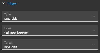

What I figured out when it was happening to me was that if it is not saving, there is something wrong with your customization. One time when it happened, I had forgotten to enter something in a trigger field (one of the below). Once I fixed it, it saved. I would review everything you did to make sure you didn’t miss something.
You know, you’d think they’d display error messages or validation checks.

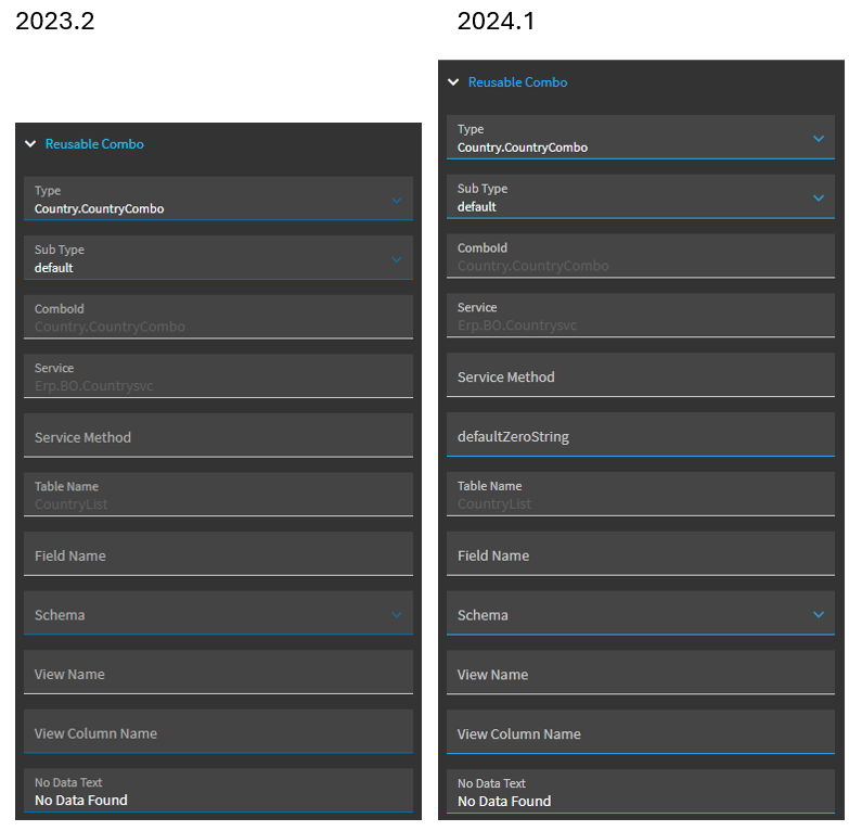

I will say the new 2024.1 color scheme tweak makes the settings easier on the eyes.
They just brightened the blue highlights… but man it makes a difference after spending a day in the depths of app-studio.
I’m not quite as old as many of my coworkers - and the low-contrast trend looks nice, but is no longer functional for my eyes :nerd_face:
