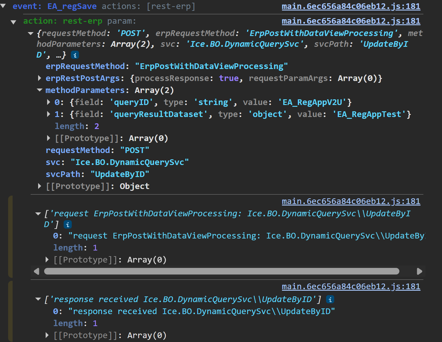

I need help with the update part of the UBAQ conversation. I can create the event shown and make it work flawlessly. But, because the BAQ has a parameter, it prompts the user for information on the update and get calls.
I see in the second link that there is a conversation about using the same widget used to call BAQs with parameters silently. However, instead of executebyid it uses updatebyid. This does not include the executionParams option in the method parameters section. Trying to add a parameter here only lets me include strings and not datasets like in the executebyid version.

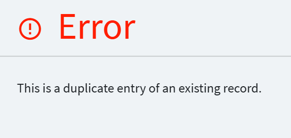

Now I’m getting the following error and can’t seem to find my way around it. Any ideas?
Looks like it’s trying to add a row that already exists instead of updating it?

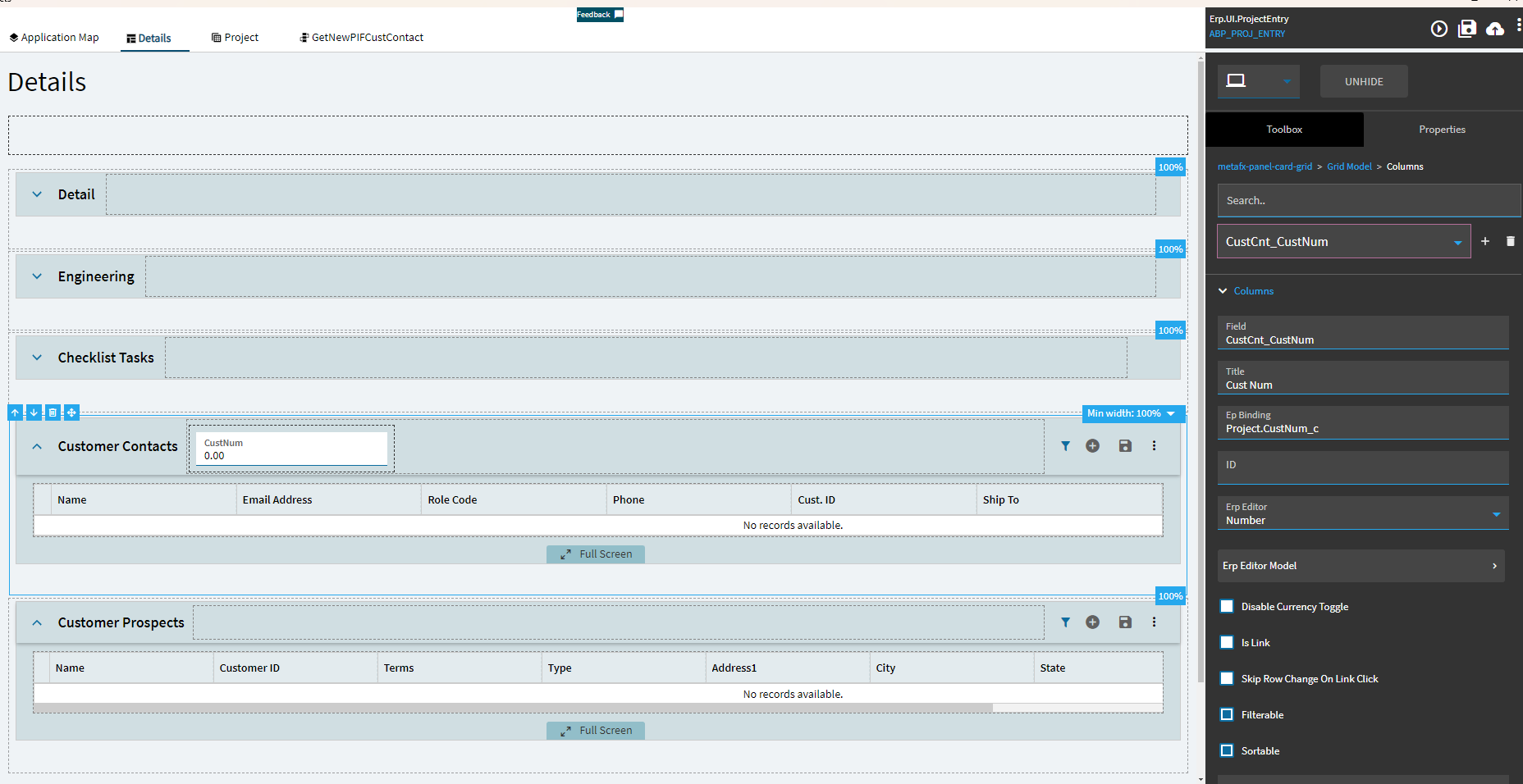

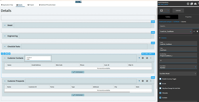

I’m trying to do something similar–I’m trying to create a Customer Contact in a Panel Grid. I’m using kinetic-baq widget. I want to pass CustNum from Project to the Customer Contact. Is there a property to set the default value for the CustCnt_CustNum column?
I managed to get rid of the “duplicate” problem by filtering the baq call with a where statement. I cannot get the update to fire correctly now. It goes through without an error, but the data does not update.

@zwilli526 mentions that all key fields for the update process on the baq have to be entered into the grid model, even if they do not need to be shown in the grid. In my case, I was trying to update anything with a blank key4 in the UD05 table. This is why the duplicate errors were pouring in. Additionally, that is why the rest enabled widget would call the updater, but nothing would go through. It’s because it was missing its required fields of company and keys1-5 for the update to be successful.
