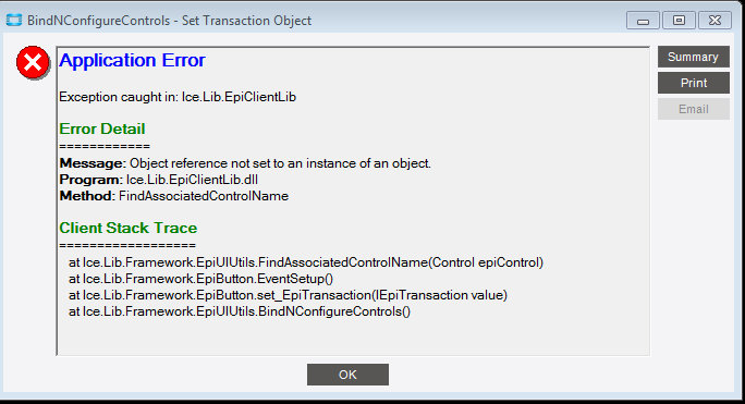

Application Error BindNConfigureControls
I have customized the Part Entry screen to only show the fields we use. I am now getting this error on opening. image
Any ideas?
Post your custom code and we can help get you in the right direction.
I will tell you that going down the path of hiding “everything you don’t use” is not as fun as it sounds, especially when you start to deal with upgrades.
I actually figured out which button it was and just made it visible again.
