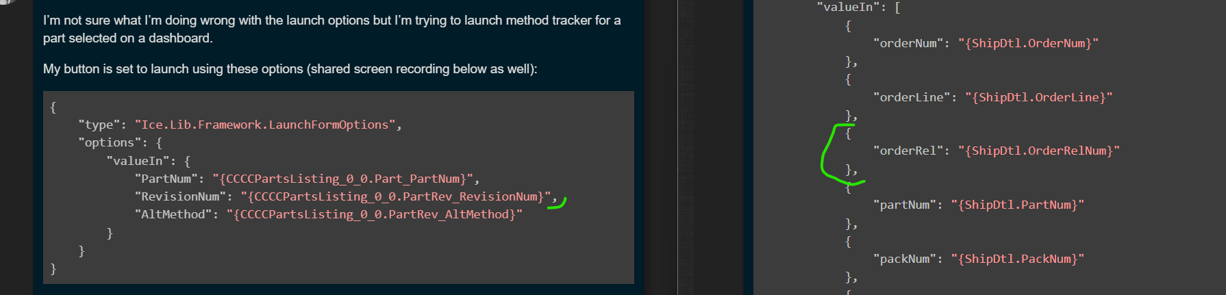

I’m not sure what I’m doing wrong with the launch options but I’m trying to launch method tracker for a part selected on a dashboard.
My button is set to launch using these options (shared screen recording below as well):
    "type": "Ice.Lib.Framework.LaunchFormOptions",
    "options": {
        "valueIn": {
            "PartNum": "{CCCCPartsListing_0_0.Part_PartNum}",
            "RevisionNum": "{CCCCPartsListing_0_0.PartRev_RevisionNum}",
            "AltMethod": "{CCCCPartsListing_0_0.PartRev_AltMethod}"
I tried passing only the part number over but that didn’t work either. It appears to be requiring the part rev which I’ve specified in the launch options above.
    "options": {
        "valueIn": "{CCCCPartsListing_0_0.Part_PartNum}"

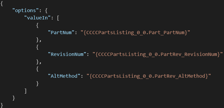

I did read that and found it super helpful! Thank you for putting the time into that thread! The difference I see in how you handle multiple values is yours is separated by curly brackets and I separated the values by using a comma. I’ll give the curly brackets a try for these options.
Curly brackets didn’t make a difference :frowning: I’ll mess with it again tomorrow. I’ve spent all day working on this dashboard in application studio and my brain is starting to melt :melting_face:

Try this (adjust names and values as needed):
Dashboard
	"options": {
		"valueIn": [
				"partNum": "{PartRev.PartNum}"
				"revisionNum": "{PartRev.RevisionNum}"
Method Tracker Layer
row-update values:
EpBinding: KeyFields.PartNum
Expression: %session.context.initialValueIn.ValueIn.options.valueIn[0].partNum%
EpBinding: KeyFields.RevisionNum
Expression: %session.context.initialValueIn.ValueIn.options.valueIn[1].revisionNum%
