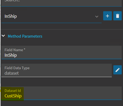

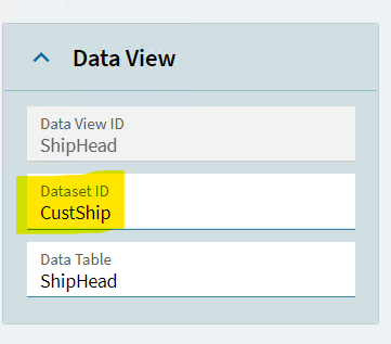

you need to pass the Dataset ID of the DataView.
I tested it and it works fine.

Leaving the DatasetID ( Parameter Name) blank works for you?
I’m doing the same passing a BAQ View to a function but it’s just not receiving the data.
Tried blank, “Results”, BAQ Name, View Name but none work.

Couple things to try:
  1. Put curly braces around your data view name
  2. Set it up in the Request Parameters section instead of Method Parameters. I don’t have an example for this as I’m currently on my phone.

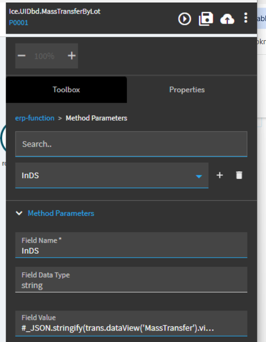

Mark , no leaving it blank did not work. I had to stringify the dataview… MassTransfer is my dataview. See below.
InDS is a string parameter on my function
#_JSON.stringify(trans.dataView('MassTransfer').viewData)_#     ```
**And in the function**
var JSON_array = Newtonsoft.Json.Linq.JArray.Parse(this.InDS);  /// Need to add Newtonsoft.Json assembly as a reference
foreach (var data in JSON_array)
     counter++;
   bool selected = (bool)data["Calculated_Selected"];
   string partNum = (string)data["PartBin_PartNum"];
   string warehouseCode =  (string)data["PartBin_WarehouseCode"];

I did get it to work in the end - it was “Results” for the dataset name.

Awesome! Did you use stringify or Hannah’s method?
I want to get her method to work, it looks cleaner and will be easier to maintain and explain :slight_smile:
Hi Tim,
Sorry for the delay - I used Hannah’s method, however I notice a MAJOR drawback with this so have reverted to your method as it work brilliantly (thanks!). The issue with passing the dataview over is if you have mixed datatypes, for example first line “Net” field is an integer, if any subsequent are decimal it is treated as an integer and gives erroneous data!
