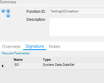

Does anyone know how exactly we’re supposed to be using the System.Data.Dataset type as an input to a function? The function has this as an option but I have been unable to find any documentation on the syntax it’s expecting. Looking at it on swagger just shows it as a string input parameter? Am I expected to just pass the whole dataset as a string inside the object and manually parse it in the function?

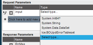

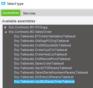

Alternatively (and probably more straightforward), use a UpdExtSalesOrderTableset from the “Select Type…” drop down. You can also use a plain SalesOrderTableset, but those can be a bit more finnicky and as a general rule I use the UpdExt tablesets when importing from outside the system.
Either way, you’re going to end up sending serialized JSON text to the function. Using the pre-defined Tablset will save you time since the system already knows what it should look like so you don’t have to define it yourself.

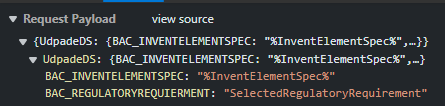

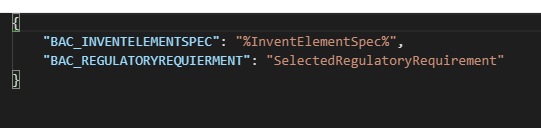

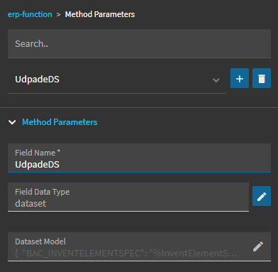

Did you try to pass dataset model with given dataviews as tables?
I have tried this but it does not work.
For the moment I am passing 2 dataviews through 2 separate input params but I’m curious if above would be possible.
