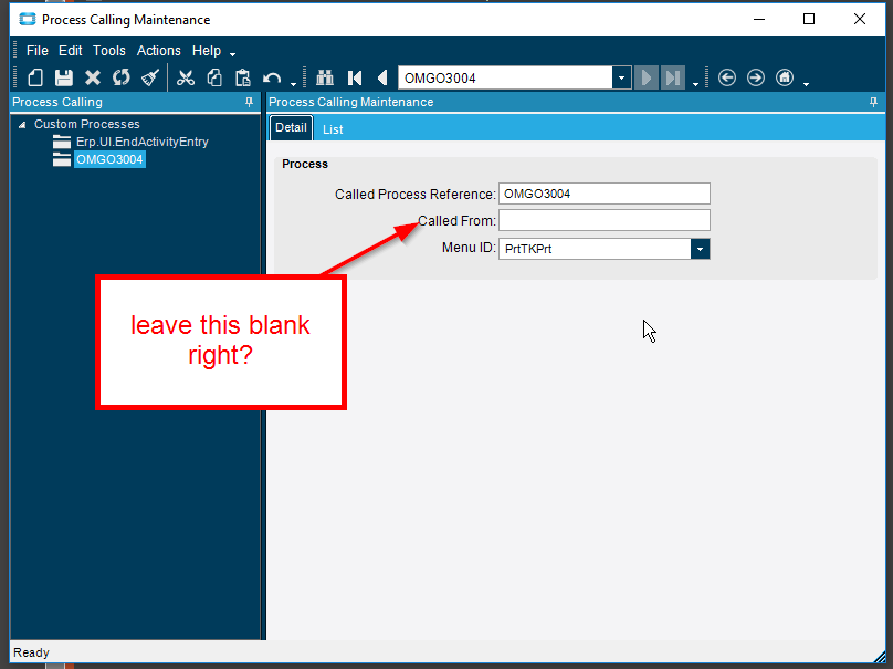

So I just got around to trying this. I am able to get the customization to work in MES by using the process calling maintenance.
I’m a little confused on how to get it to show up everywhere though. If I created a new menu item, but don’t put a called from/calling parameter in, how does the system know to use the new menu item?
The Called Process Reference should be Erp.UI.PartTracker not OMG03004 and it should be enough to have 1 for all the menu’s
ok. For future reference, how do I know what to put in the called process reference? I am using the developer mode with MES like you said and this is what it shows me, which is why I put in OMGO3004. Do I need to look in a trace for that or something?

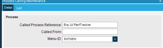

So I put this in there
That doesn’t seem to work to open the customization from everywhere.
When I do the right click open with, I get this.
Looks like I’ll just have to set it for each menu item. Thanks for your help.
You shouldn’t have it do each menu item. Try using the Erp.UI.PartTracker.dll instead… or recycle your app server after setting it.
