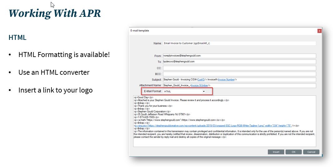

That was added and working in an early version of kinetic. I included that in my insights slide deck last year, it works nicely.
Basically, you can use an html editor and hand code last I checked. you can drop in RDD values into the code to link to tracking numbers and other data fields.
