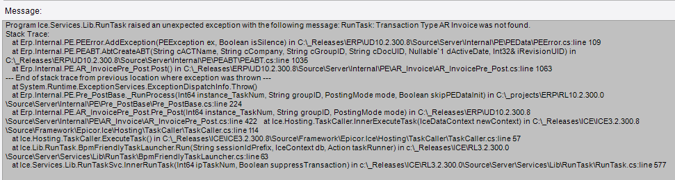

I was trying to post an invoice but I keep on getting this error:
Any advice?
I already have my certificates.
Did you import your posting rules?
Where I can do that? Im kinda in a Hurry hehe
GL Transaction Type. All your answers are here:
https://epicweb.epicor.com/doc/Docs/Epicor10_TRPostEngine_102300.pdf
Also search, “Import G/L Transaction Type” in help.

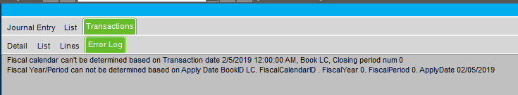

It´s my first invoice for this company! I just solve this, but now send me this:
Did you (or anyone) setup the fiscal periods?
And when I asked if you could post before, I meant that is anyone had successfully posted, and that this error is new.
I already set the fiscal periods up, and this is the very first invoice.
