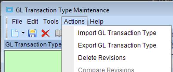

I don’t see the “Import ACTTYpe” menu, I see “Import GL Transaction Type” instead:

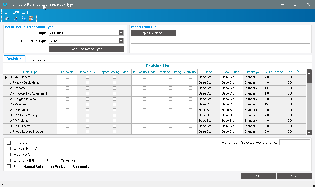

In any case, where do you get the post rules from the import? I tried exporting from the E9 GL Transaction Type Maintenance window but it created a bunch of XML files, not a zip file. What flags should I select from tune “Install Default / Import GL Transaction Type” dialog?
50%20AM
If I just select “Import All” I get:
If I say “Ok” I get:
Which sounds scary enough that I dare not click “Ok” again…

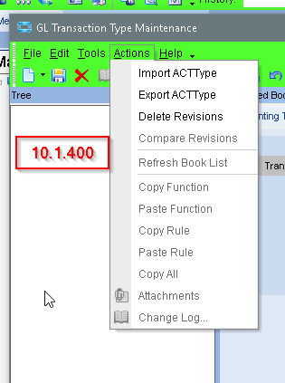

I think the menu changed since 10.1.
10.1.400
And
10.2.300
And the Conversion Workbench in 10.1.400
I can’t find the Conv Workbench in 10.2.300

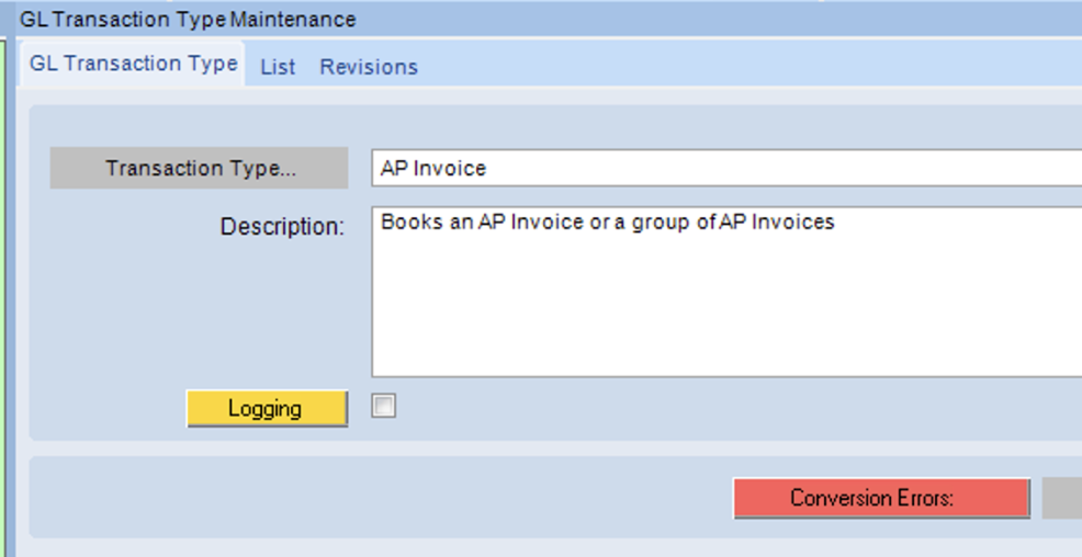

I didn’t see any issues with the conversion, it finished - but I do notice that if I bring up the AP Invoice transaction type in GL Trans Type Maint There is a red “Conversion Errors” button which I’m not sure how to get rid of. How do I see/fix the errors?

Using the “Import GL Tran Type” (in 10.2.300), I can see:
I assume I would mark the “Import All” checkbox
