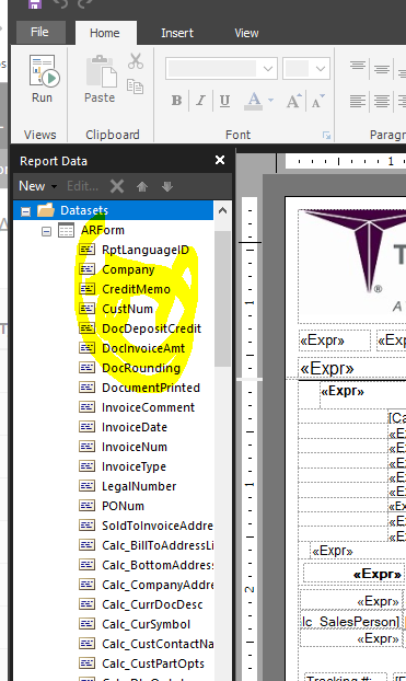

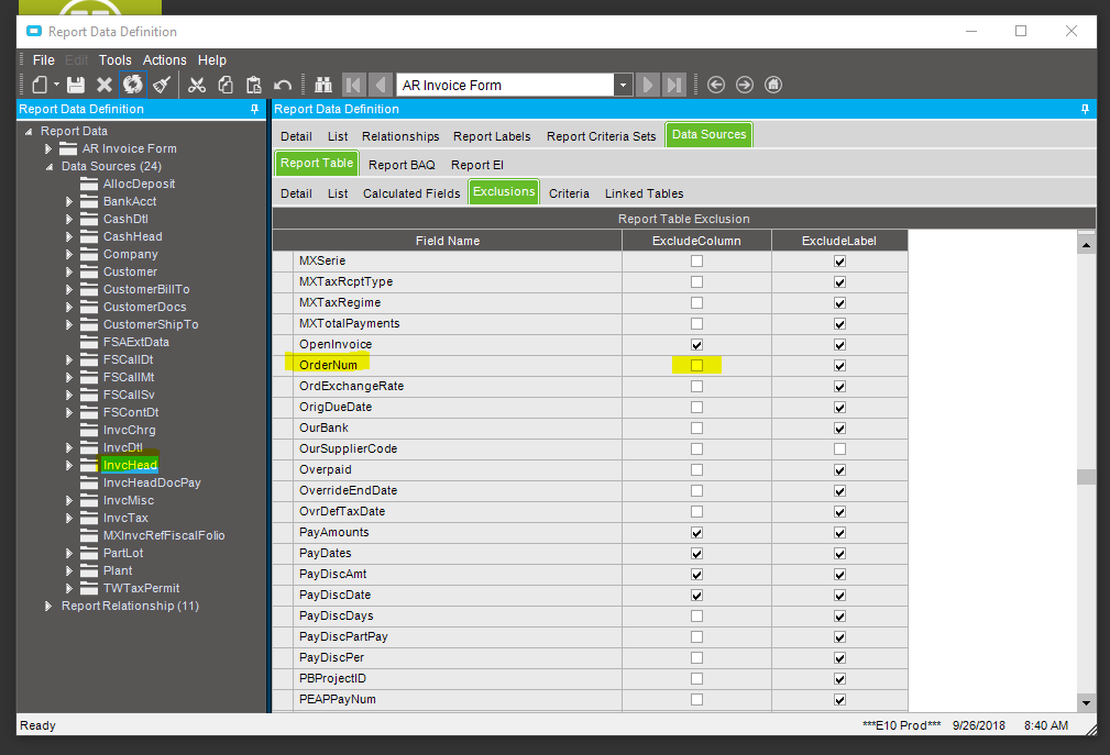

I saw an other post someone had issues with the upgrading of the ARFrom RDD. My issue is with the AR Form RDD too but i am starting from scratch just having issues. The biggest issue I am having is the columns that are on the RDD don’t appear on my SSRS report. The odd part is these are not columns I have added these were already there from Epicor standard RDD. As you can see from the screen shot this field is not excluded on the default RDD but I don’t see it in my SSRS dataset.
I have also tried to add the field in the dataset but it turns no data.

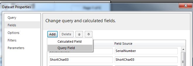

When you added the column to the report, make sure you select add query field.

4
I did do that but still doesn’t work.

6
you mean the dataset?? this area highlighed in yellow

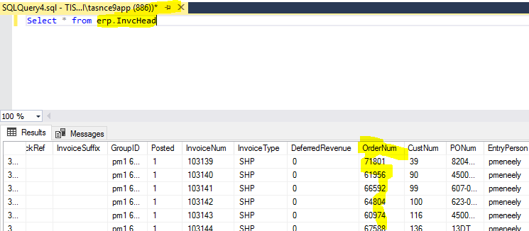

8
Yes, looked in SQL and the field is in the table and has data.

9
That’s a query of the InvcHead. @knash is referring to the temp table in the Report DB

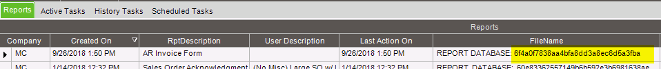

When you print an invoice the RDD creates temporary tables with the reports GUID as a suffix of the table name.
For example. I just previewed an invoice and the Sys Monitor shows:
the 6f4a0f7838aa4bfa8dd3a8ec6d5a3fba is the GUID that is added to the RDD’s table names.
