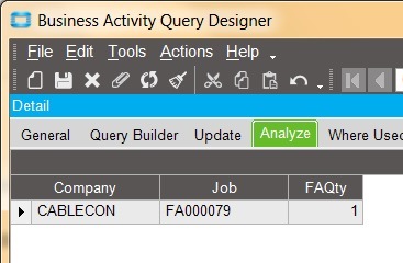

If I check the data with a BAQ, the data is there. I am currently on 10.1.400.14. I am having this problem on this report and the MtlTag. Consultants have created custom forms for us on 10.1.400.12 and the UD field data came in no problem. Is it possible a bug is causing this problem for this version? Am I missing a step to get the UD Fields to display data in the SSRS database?

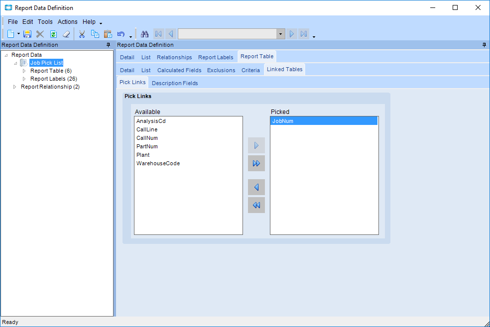

I have posted a bunch of screenshots show the data in the BAQ, the RDD field being included, the RDD Join, and the data in the SSRS database.

The JobHead table is already linked to the RDD through Linked Tables. Add JobNum to the Picked Links and then on the Description Fields sheet, select the UD field to add to the report.
You will then need to add the field to the SSRS DataSet Query and the Query Field to the DataSet Fields and lastly the field to the report itself.
The field name will be T1.JobNum_FAQty_c
Adding the field through Linked Tables did the trick. Thanks!!
