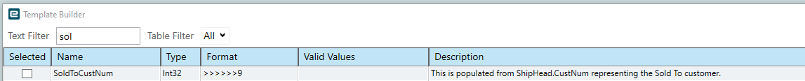

This is what I see for that field in the AR invoice combined template . . .
Correct, it is also on the AR Open Load template but does not work in Open Load.
Right but do you see the note there? To me that implies it can’t be set directly in this template. I haven’t used this particular template but I run into that with DMT a lot, where the field you want to update can’t be updated directly.
