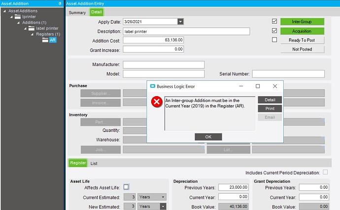

Hi all,
We are also facing the same issue. We have already depreciated over 25 months, remaining is only 11 month. We want a solution like, how this can be handled.
When adding an asset, check Inter- Group flag and you should be able to enter previous year depreciation and YTD depreciation.
Thanks arul shankar for the reply.
yes i tried the same,but it shows the error like "An Inter-group Addition must be in the Current Year (2019) in the Register (AR)"
Our Issue is our main financial book started Nov 2019 but we have asset from year 2018.
Add Fiscal Year for 2018 and then you should be able add it. Recently I have to define Fiscal Year from 1969 when implementing Fixed Asset module as client has assets from 1969.
