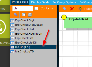

I’m interested in a solution. Seems like you would need a Query for each individual table as the change log is not stored in a single table. Or daisy chain them together I supposed.
The change log is a single table.
I have done several “tricks” to filter out change logs, but they typically are looking for certain values. The ChgLog table has several important columns, and i typically look at the following columns:
Then will add a PARAMETER to the BAQ to ask which table name you are interested in, UserID, as well as a date range. I apply those filters to reduce the data… then you can add one additional “key word” filter to find data in the Log Text I am attempting to find. but again, this can all depend on your needs.
