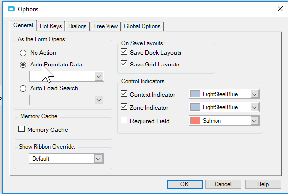

For some reason all of a sudden all my forms have the auto populate option selected.
For forms with small amounts of data this not to bad but if I open a form we have lots of records for it’s time to go have a break as Epicor is then locked up.
Any idea why it would suddenly have auto populate set for all forms?

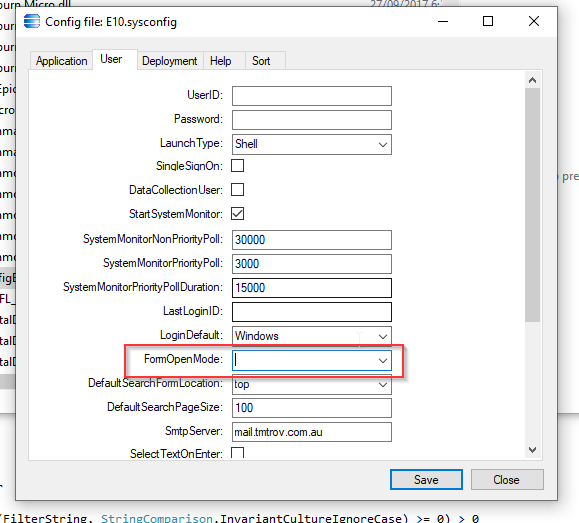

I did. Not sure how it happened in the first place though. Check your sysconfig file for the field highlighted in screenshot below. note: run ConfigEditor.exe in the client install directory.
Cheers
Brett
Thanks Brett, problem solved.
