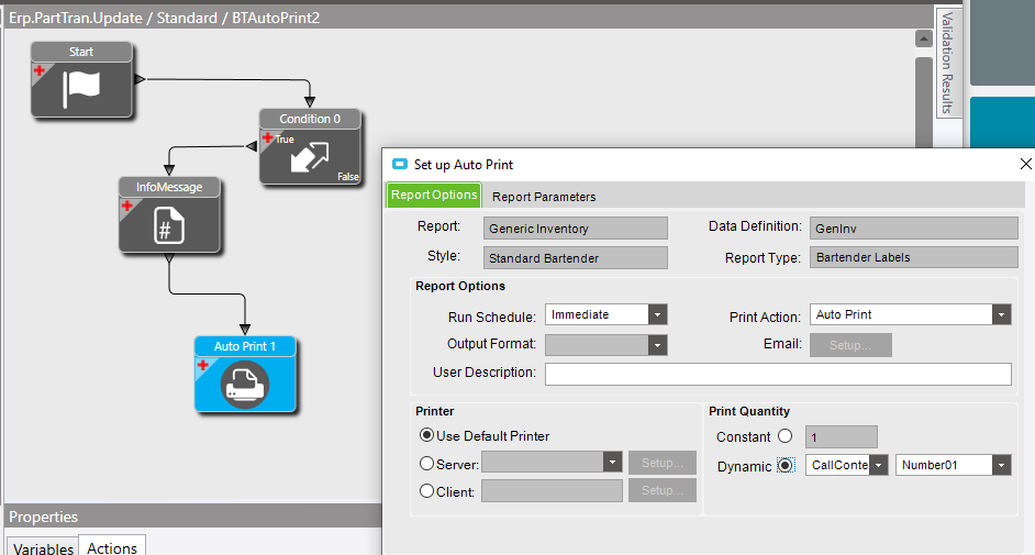

I’m using Auto Print in a Standard Directive to print Bartender Labels. The amount of labels to print is to be inputted by the user. If I set the value to a constant in the Auto Print widget, it works perfectly. Now I’m trying to use the dynamic option and use callcontextbpmdata.Number01 being set in a BPMdataform and it only prints one label regardless of the value I input. I have a message box that tells me the value of the field is being set but for some reason Auto Print just ignores it and only prints the one label… Any ideas? I’m sure there are other ways to go about this but seems like this should work.

Can you show how you have it set up?

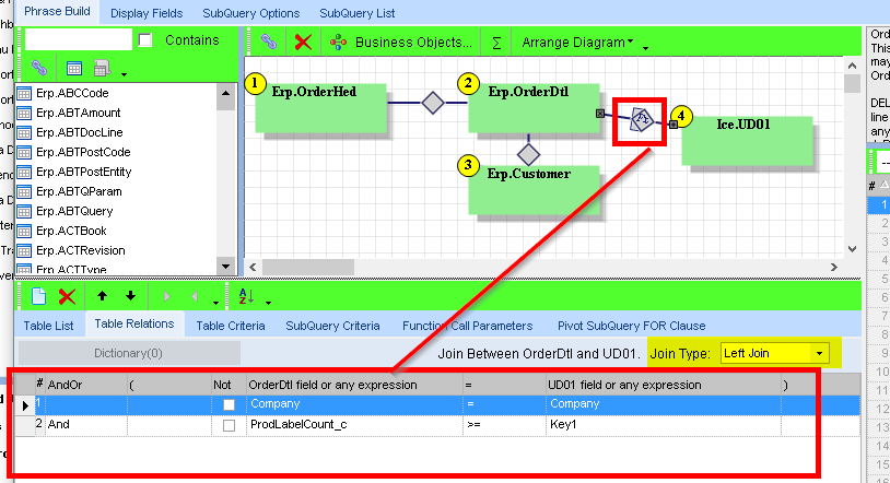

You could make an alternate label whose BAQ joins a table that that causes multiple records to be created for each label. The BPM would think its printing just one label, but there’d be multiple identical records, thus making several labels.
I did it by making a UD table with Key1 values of 1, 2, 3, …, 99, 100. Then the BAQ for the report has a subquery 2 on that UD table with the table criteria Key1 <= @labelCount. Then join subquery2 to the main one and you’ll get multiple copies per original record.
There’s a way to do it without needing the UD table, but it escapes me.
If I had to guess, it’s because the callcontextbpmdata table isn’t part of the GenInv report and can’t use the value.
@klincecum this is how i had it setup, I’m setting callcontextbpmdata.Number01 in a pre processing bpm in another method. The Custom code block just pops up to make sure the value is being set.
Another way around this I found is to loop the auto print widget and subtract 1 from the variable and have a condition block to check if it’s > 0. Not ideal but works. However, I’m probably just gonna create the csv in a custom code block and be done with it.
