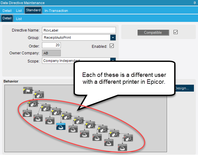

In a similar situation for receipt labels. We added all the label printers to Epicor printer maintenance, then made one BPM that had criteria for users. If a certain user triggered the BPM, then the auto print went to their printer.
Since our company is relatively small we were able to get away with this method.

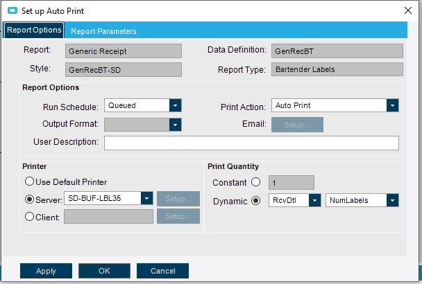

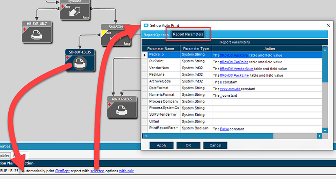

If anyone wants to Print BT Label to File with the “Client Printers” you can. You are not limited to just GenShip, GenRcpt, GenInv… (this does not use Auto Print BPM)

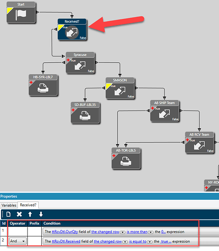

Can you give me a breakdown of the fields and tables used here please?
if ttRcvDtl.OurQty > 0 AND ttRcvDtl.Received = true
Then it runs through the auto print rules. Some more info on the auto print option below: (Auto Print is one of the items you can drag from the left hand panes to the BPM workspace)
