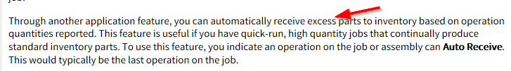

I haven’t verified this, but the help says that box is for “Excess” parts.
We actually accidentally ran across this in one of our sites. If you have a job that has a Make to Order demand link and Make to Stock demand link, Epicor will only automatically receive parts to stock after you have completed the MTO quantity. If you have no MTO link or quantity, all parts produced on that operation are received to stock automatically.
