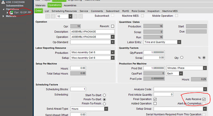

Auto receive check box has been enabled in the Job Operation but when the operation shows are completed it suppose to automatically processed the “Job Receipt to Inventory” transaction is not happening automatically in the system . Any thoughts ?
  1. Job Operation enabled “Auto receive checkbox”
Note: this kind of issue has been happening more often now days.
Version : 10.2.500.33

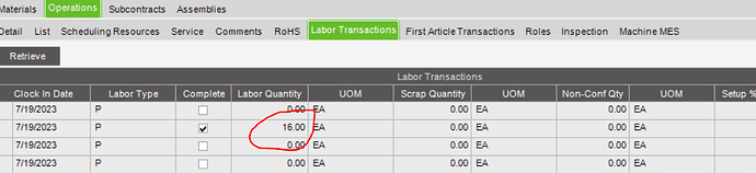

I don’t know if this would be an issue, but there is not a start or due date on the operation. Has the job been scheduled. Also look at the labor transaction tab in job tracker for the quantity completed on the job.
I have checked in the labor transaction in job tracker. Qty completed.

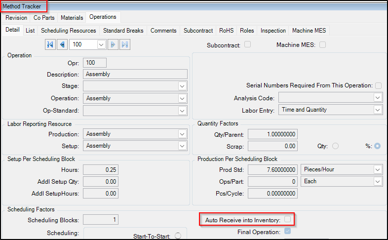

What are all of the start/end activities after the completed. I would expect to see the completed at the last transaction or once completed the rest would also show completed. Even then each quantity should have a corresponding receipt. Below is a sample from my system.

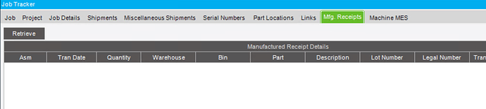

Mfg Receipts
Labor Qty 16
I clicked retrieve button on the Mfg Receipts nothing has come. Because Job Receipt to inventory does not happened automatically.

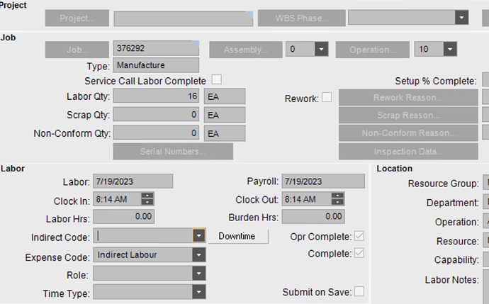

Posted timesheet entry

We were having that issue - the operator saw the “Request Move” box on the End Activity screen and starting checking the box. We don’t have AMM licensed, so the parts went into a black hole.
I did report it as a bug, but told it was working as designed.
In every case this has happened, we’ve gone to the operator and they’ve known they did it. Training resolved the issue for preventing in future. Manual Job Receipt to Inventory helped resolve the problem jobs.

Do you have Auto Receive set here on the Method (BOM)?
Or are you setting it manually at time of job creation?
The resource groups we have are set up like this and work without any issues for auto receive.
If you are setting Auto Receive at the Job level I would enable the change log on that field and next time it doesn’t do what you want check the log to see if it was enabled before the labor transaction happened.

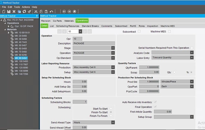

Yes. Auto receive check enabled in the BOM level, Resource group level, resource level and job level also
That is a different part number than what you started this thread with. Is your part 84228496 configured the same?
Same configuration
