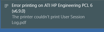

I have a similar (but not exactly the same) issue with scheduled emailed reports. Mine aren’t break routing either. If I run a report and choose to email it (instead of printing or previewing), and select a recurring schedule, the email goes out fine. But the next time I launch the client, I’m presented with a “Save As…” dialog box to save the PDF that was created for the report. To be clear the “Save As …” window doesn’t appear until after the scheduled time (usually at midnight, and with no client open).
Maybe it has to do with the client’s default printer. Like I’m getting the "Save As… " dialog because my workstation has a PDF printer as it’s default printer. If mine had a regular printer, it would probably just get sent right to the printer.

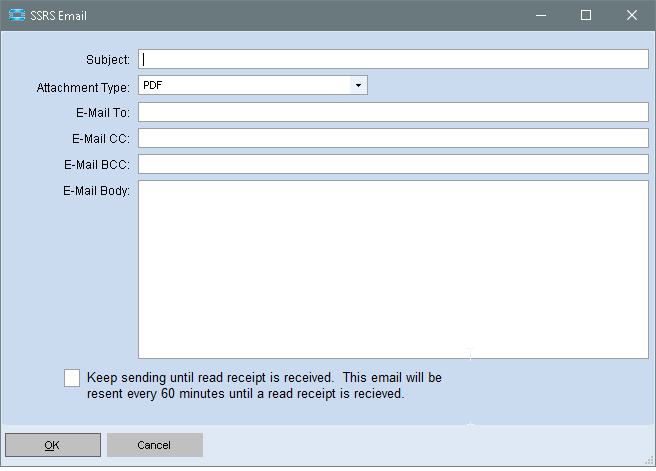

Add a checkbox in the email settings dialog, like:
:wink:
One thing I failed to mention. This only happens in my Test environment!
The very first thing I do when I setup an email account is to turn off read receipts.
I also generally read the text-based versions of emails for privacy/security reasons so web beacons won’t work either.
:wink:
Whew… that’s a dangerous checkbox. Someone somewhere hates you, I’ll guarantee it. As someone that doesn’t use read receipts, this would piss me off haha.

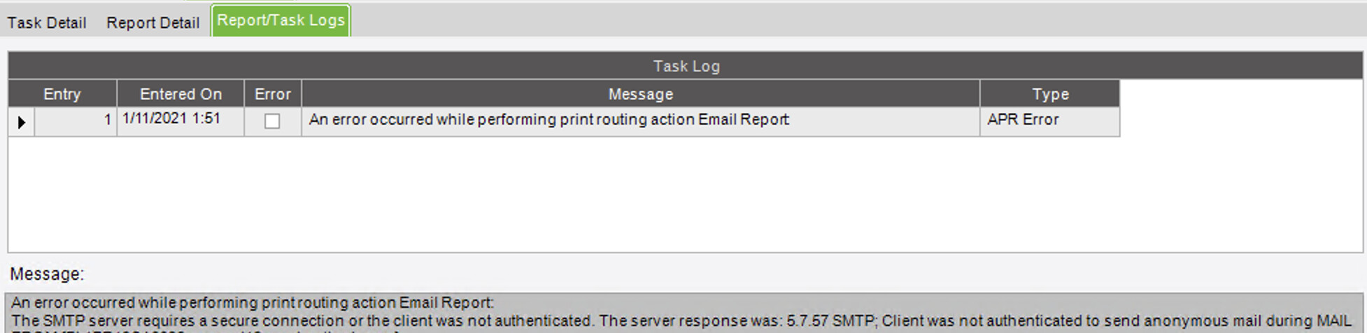

I just did a test (in my test environment), emailing a simple built-in report to myself, after changing the default printer on my workstation, and got:

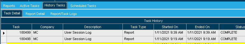

Looking at the Reports tab in the System Monitor shows the report was "Created On: 9:19:05 AM. And has a “Last Action On” of 9:19:34 AM
The headers in the email I received say it was received by our exchange server at 14:19:05.8654 (the 14 to 9 is the timezone diff).
9:19:04 - Report rendered (that’s the time shown on PDF that was emailed)
9:19:05 - Report was created on the App server (per Sys Monitor)
9:19:05.9 - Email received by Exchange from App server IP (per email headers)
9:19:34 - Last Activity Date (per Sys Monitor)
I bet If I had closed my client right after submitting, the email would go though, but the failed print message would n’t show until the next time I launched the client, which launches Sys Monitor.

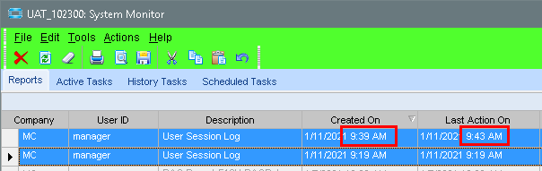

Just as I thought. The attempt to send the report to the print happens when the Sys Mon is loaded (for the specific user).
  1. I submitted a report to email and exited the client immediately.
  2. Waited until I received the email
  3. Launched the client as a different E10 user. No attempt to print occured.
  4. Sys Mon set to show all task
  5. Sysmon shows this email and the previous email both completed
  6. The Reports tab only shows the prior email (the one that tried to print)

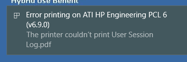

  7. Closed E10 client and re-launched as user that submitted email. A few seconds after the Sys Mon loaded, the Print Error notification appeared:
  8. Opening Sys Monitor shows the last activity of the 2nd email to be right when Sys Monitor was launched for this user.
I only seem to get this when using the email “destination” when printing.
