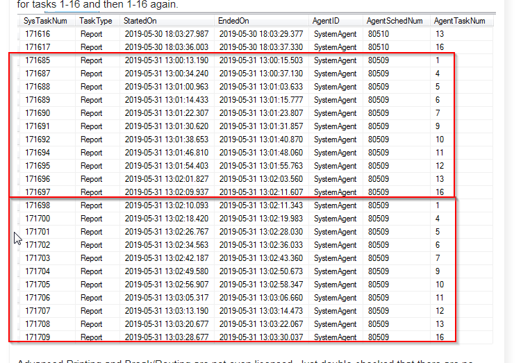

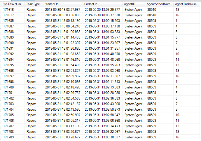

Here’s the duplication from this morning in the Ice.SysTask table. You can see the same agent schedule for tasks 1-16 and then 1-16 again.

Using the pict below…
  1. At 13:00:13.190, the Task Agent looks at the schedule and sees that schedule 80509 should be run after 13:00:00, so it creates the 16 tasks tied to that schedule.
  2. It looks like it takes anywhere from 15 to 30 seconds for each task to start.
  3. Before the last task is started, the task agent sees that the current time is past the scheduled start time of schedule 80509. So the 16 tasks are started again
  4. After starting the last task of of the first time schedule 80509’s task were started, it updates the next run time of that schedule.

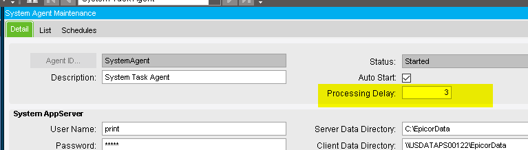

What do you have as a value for the Sys Agent Processing Delay?
I recall reading on her that it should never be zero.
Here’s what the Help says:
Processing Delay
Use this field to regulate how long it takes the system agent to process tasks. The value you enter defines the length of time the task agent remains inactive at the end of processing loops. When a processing loop begins, the task agent runs all available tasks. When these tasks complete, the task agent stays inactive (or sleeps) using the Processing Delay defined on the system agent. When the system clock reaches the end of this time duration, the current processing loop ends and the next processing loop begins.
If you have a fast server that can accommodate the network traffic, enter a lower number in this field. A value of 10 indicates ten seconds must pass at the end of each processing loop before the system agent starts the next loop; a value of 60 indicates that a minute must pass before the next loop begins.
Example: You set this field to 60 seconds. A user submits a report using the Now schedule. It will take a minimum of 60 seconds for the task agent to run this task after it finishes the current processing loop.

And from the order they were run in, the second starting of AgentTaskNum 1 (SysTask 171698, @ 13:02:10.093) didn’t happen until after AgentTaskNum 16 (SysTask 171698, @ 13:02:09.937) was started .
The processing delay is the default 3. And unfortunately I don’t see how I can save emailing a report to a process set, so I’ll try splitting the schedule.
