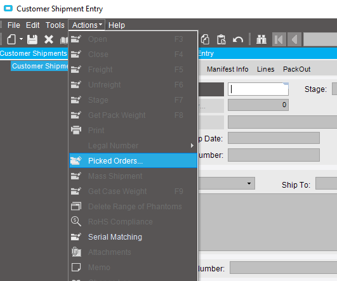

If the Fulfillment workbench -> picking process is followed,
then creating a packslip is just 2 steps from the customer shipment entry.
Click on picked order that allows you to select the required picked lines and create pack.
