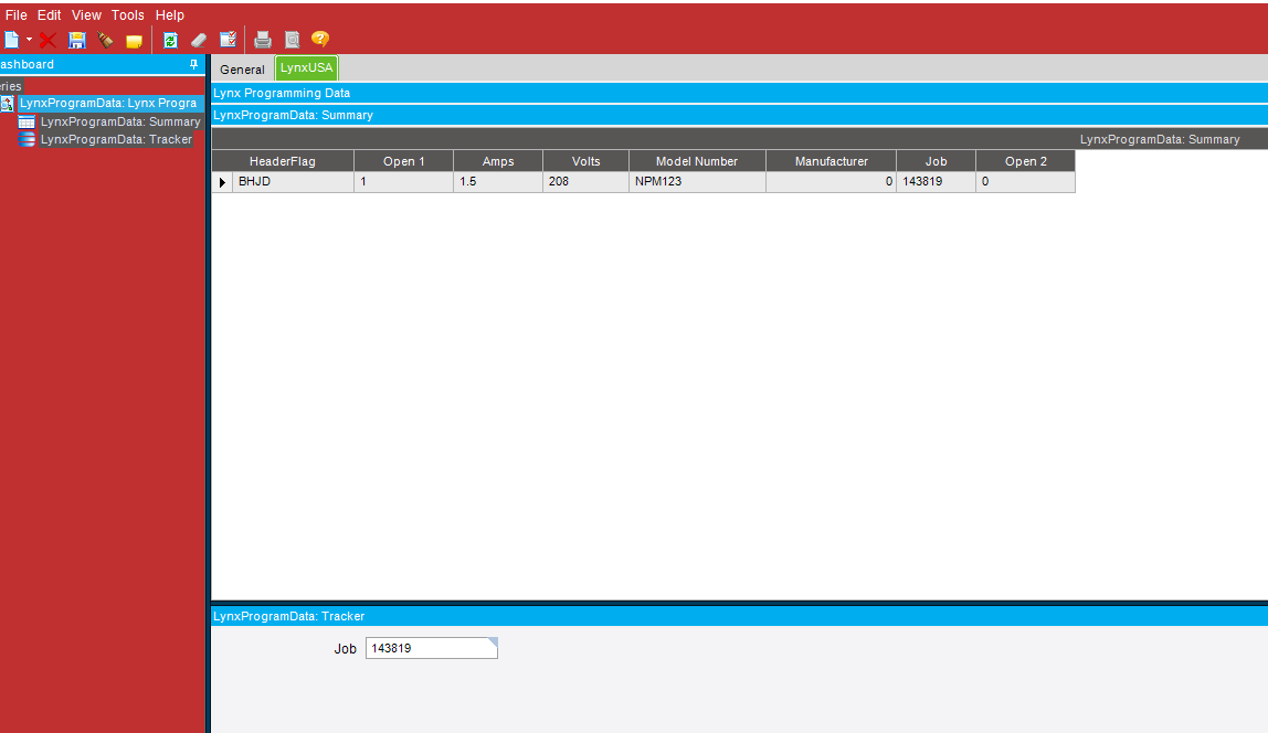

So, I have a dashboard with a BAQ.
The dashboard has a tracker view, and an employee will filter the query by Job Number, and we want a csv to be generated on the local C drive with the results.
(They will scan a barcode to fill out the job num, then the query will be refreshed and give only that data).

Well to answer your question, you could add a Customization Layer on the Dashboard and listen for the “RefreshTool” event click (AfterToolClick) (you can find that in the Wizards) and then you can just via basic C# get the Grid Data (DataRows) and using basic # Write to any file.
