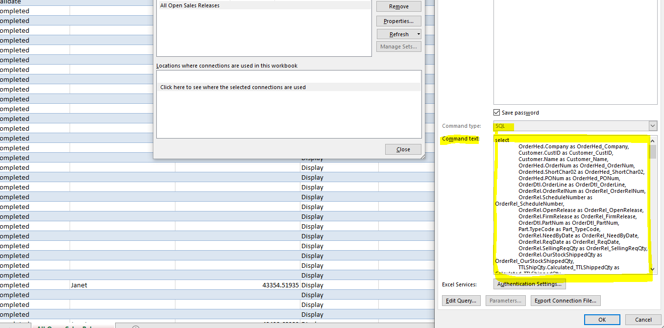

if you your final user will view the file from within your internal domain and your epicor version not supporting REST, then why not using the SQL statement (string) of your BAQ and call the DB instance straight away from your Excel/Power BI file
