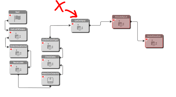

I am trying to do a little bit of automation of fulfillment workbench. I have started an Epicor Function that performs an “inventory transfer” and “allocation” for pieces in a given lot. For now, I am concentrating on implementing only the “allocation” step. Here’s roughly what I’m trying to achieve:
For a given qty of a given lot:
  1. AllocateByLotBin() such that either all orders are filled or the lot is fully allocated.
  2. AutoAllocate() to dip into inventory to fill orders if needed/possible
So far I have identified most of the chain via traces, but I’m stumped at an error that’s occurring when I call Erp.OrderAlloc.GetLotBinOnHand().
Error Details:
      "Message": "You need to select one demand record.",
      "Type": "Error",
      "Program": "Erp.Services.BO.OrderAlloc.dll",
      "Method": "GetLotBinOnHand",
      "ColumnNumber": 17,
      "LineNumber": 5511
BO Methods:
  1. Erp.OrderAlloc.GetListOfOrders()
  2. Erp.OrderAlloc.OrderAllocationGetRows()
  3. Erp.OrderAlloc.Recalculate()
  4. Erp.OrderAlloc.CheckDates()
  5. Erp.OrderAlloc.OneDemandType()
  6. Erp.OrderAlloc.GetLotBinOnHand() <---- Error
It seems after OrderAllocationGetRows() I have an OrderAllocListTableset with the expected record in the “OrderAlloc” table. Next, I pass the OrderAllocListTableset to Recalculate() which appears to clear the “OrderAlloc” table and add to the “OrderAllocSupply” table. The problem now is that I need to pass the OrderAllocListTableset to GetLotBinOnHand() in order to return the available lots, but there is no “select” field on the “OrderAllocSupply” table for me to indicate which “demands” to select and satisfy the error.
Any ideas?
