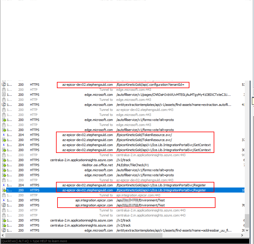

I just did again ran it through Fiddler Classic and these are really the only calls that are made (all from within the browser / client)
It basically
  1. Logs in to your Epicor
  2. Gets a Token
  3. Registers the Service to the Instance
Profit
It all happens client side so there should be no network related things or issues you need to be dealing with. I wonder if your browser is blocking some stuff, do you have UBlock Origin or any weird extensions installed?

Don’t have anything fancy installed. Using chrome, but I get the same result within the client as well. Those are the calls when you are on Projects/[Project]/[Connection] and you are clicking Connect?
