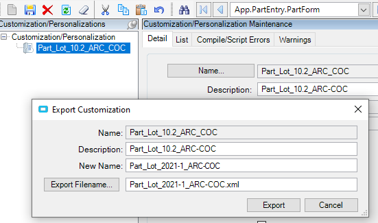

You can Export and Import Customizations from the Maintenance menu under Actions.
Hi
Thanks, can you tell me how it works please?
I have just clicked on ‘Export Customization’ and it has done nothing.
Select the custom you want and select Export. Fill in the box that appears with a name and location to save. This is an on prem instance.
