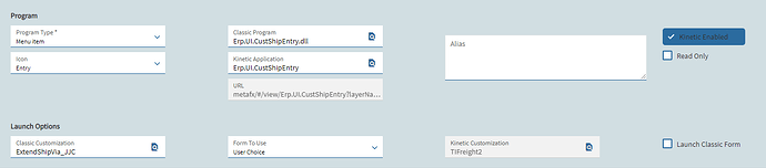

When I am in kinetic menu maintenance, and I have a “menu item” with a classic customization attached, I am able to browse and also select a kinetic layer to attach - its not disabled even though it does look sort of grey.
You may need to click the three dots, or wherever the option is, and choose “Copy to Current Company” before you can select options.
Right- in my case, it was a pre-existing classic customization, so it had already been copied to the current company and I was just adding a kinetic layer on top. If it was a standard menu item it would have to be copied first.

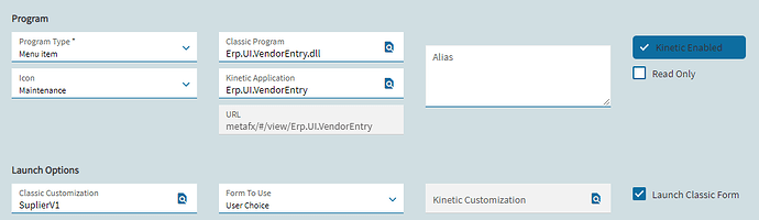

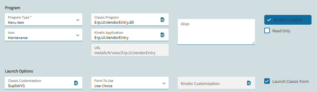

Well in my case it is already copied I had classic customization and converted it to kinetic but I am not able to see any kinetic layers (picture bellow) until i change program to kinetic app but after that I am not able to add classic customization
P.S. Allso classic customization search does not show anything I need to type customization name manually
Uncheck launch classic form?
Is your layer definitely published?
This does not help also, yes it is published did this 4 times :joy: might be it is search issue :confused: because classic customization search does not show anything also I need to type customization name manually
What version are you on? You are showing 2022.1 in your profile but as I mentioned this functionality was added in 2023.2.
Forgot to update profile now we have 2024.1.5
Ok found issue :confused: when i used conversion workbench it converted customization and assigned it as company specific and since menu contained checkbox “All companies” customization was not visible in search :confused:
