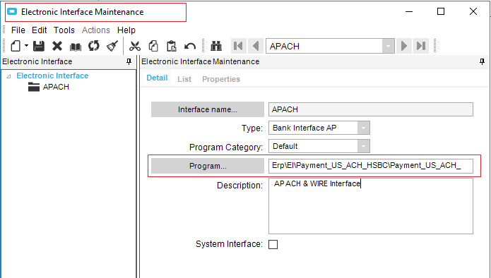

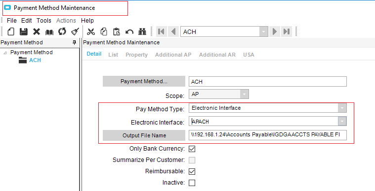

@dineshparashar, There are many C# “Electronic Interface” projects under “C:\inetpub\wwwroot\EpicorERP\Server\Erp\EI” folder, refer this projects and do customizations based on your requirement.
These two setups are required.
