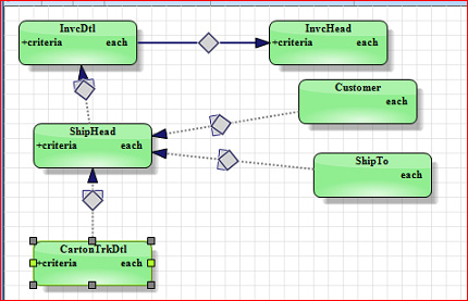

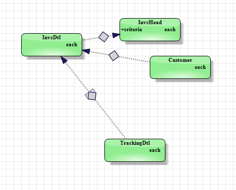

This I think will get you what you want. image
If you need more than the first tracking number you need cartontrkdtl. You have to make the join manually. The join would be company=company and packnum=packnum.
then set criteria

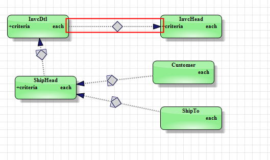

I done this minus the invcdtl=invchead (packnum) because invchead didn’t have this option and now I am getting a lot of repeated lines:
Also, the circled connection is not bold?

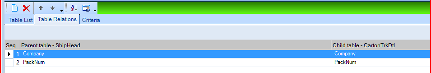

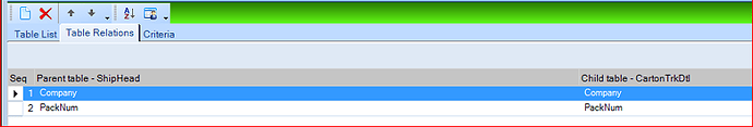

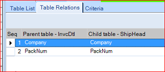

To do a manual join, click on the line between the tables, then in the table relations tab. click the new button and add as below.
The bolding indicates it is not an outer join. it should work as an outer, but there would always be a detail of a valid invoice header.

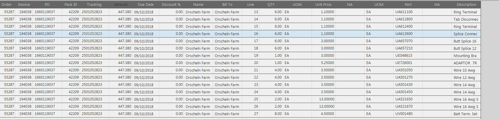

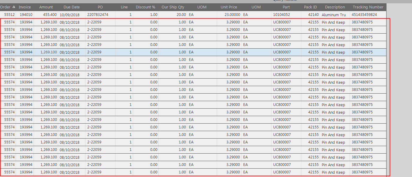

It did get rid of the duplicate lines, but I did not notice that it made all the tracking numbers and customer/bill to customer the same until I started to invoice…
Am I doing anything wrong?
Take the outer join off from InvcDtl to Shiphead.

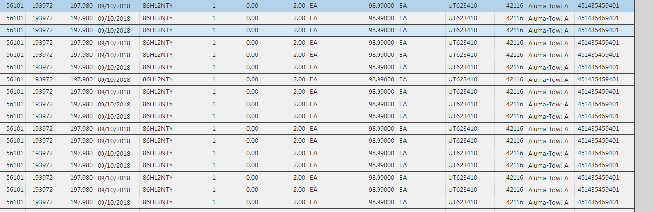

I took the outer join off and it’s still pulling the same tracking over (I deleted the customer name/bill to for now) since I was about to invoice another group and didn’t want the duplicated names

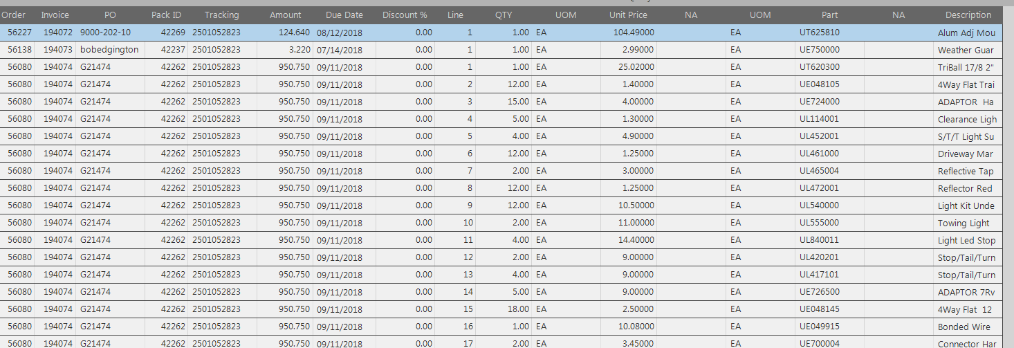

Is that the whole tracking number? It seems short and I can’t see a way that three different shipheads can come up with the same tracking number.
For the image you uploaded, the 17+ lines will all have the same invoice number and packnum, so all of the tracking, customer, etc. would also be the same.

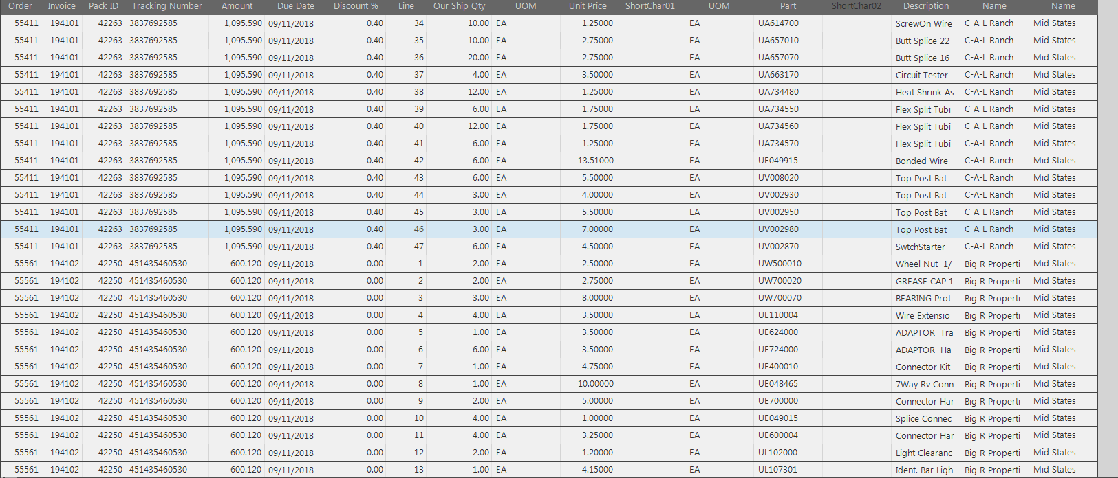

I should have used a better example, but this isn’t even a tracking number we use.
The first order should have a tracking that starts with 4514etc and the second one shouldn’t even have a tracking number since it was a CPU. for the large order the po should have started with a fedex freight tracking 3837etc.
So I am unsure of where this tracking number comes from (along with the customer “Orshelns” ) we haven’t even used this customer yet (new customer from several months back but have yet to create a order).
it seems like the link from invcdtl to shiphead is the issue. I would show the packnum from invcdtl and shiphead to make sure they match.
Is it like this?
I am almost positive that did the trick
