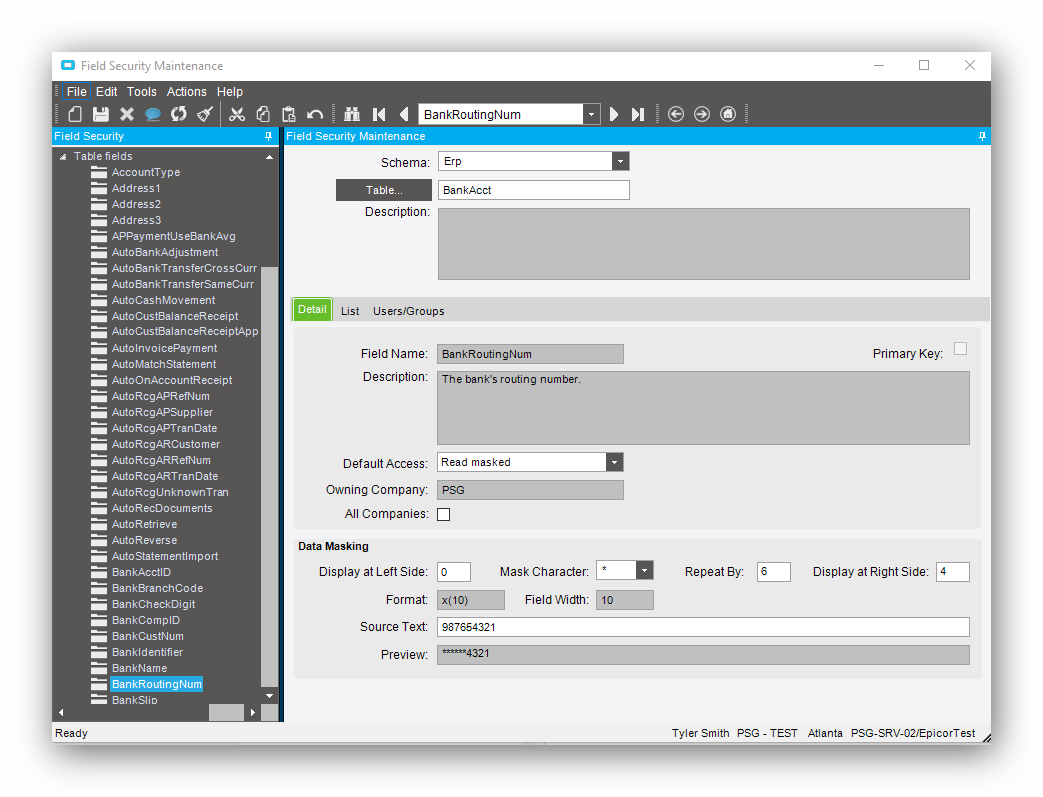

To the original topic about security in BAQs and Reports: all BAQs (and RDDs as far as I remember) run through Epicor’s security layer. This lets you (or Corporate) define which fields are available, read-only, masked, etc. for each user including power-users who can build BAQs. The security is on the field level, not the table level, but the security is followed even in the BAQ designer.
Using Field Security Maintenance, set the BankAcct.BankRoutingNum field to Read Masked for all users except security managers. I also set the BankName field to None access.
Logged in as a non-security manager user, open BAQ builder and pull a BAQ using this field. Note that the field comes through masked.
The field I made hidden isn’t available in the BAQ Designer for this user. You can still add it to the query, but it will show blank unless you have access.

Since Masking was mentioned, I wanted to share notes I had it may be helpful to someone…
Data Masking Tips:
• Does not impact security manager users
• Can only be used on character fields that are defined up to x(100)
• Like field security, can’t be used on fields within a primary key
• BPMs do NOT show masked data
• BAQs do show masked data
• When Full Masked access is used, data that is supposed to be masked should not contain the selected mask character
• Not the same as SQLs dynamic data masking (DDM) functionality
Yes. Numeric masks would be quite helpful for costs, etc.
Nice feature but more MVP than a lovable feature.
Assuming the masked view of “1234-5678” is normally displayed as “XXXX-5678”…
Does “BPMs do NOT show masked data” mean that data that has the mask applied:
  1. Is not shown at all (i.e. - as "")?
  2. Is not masked (i.e. - as "1234-5678")?
  3. Shows only the unmasked part(i.e. - as "5678")?
BPM = Not Masked - so it would behave normal, as if you did not even create a Mask. 1234-5678
BAQ - will be Masked XXXX-5678
