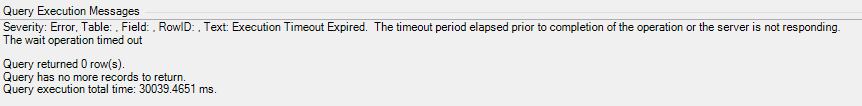

I have a BAQ that works throughout most of the week, but every Sunday through Monday it seems to just freeze and I cannot figure out where or why. I have troubleshot this thing, subquery by subquery. Everything seems to be working just fine until we hit the top level and then it just times out. I have adjusted the timeout for it to be 500000 ms, but it gives the below timeout message:
Funny thing is if I wait till Tuesday it works just fine the rest of the week. Below is the phrase build. Any and all assistance is appreciated.

I’ll work towards getting those optimizations made. In the mean time, is there something else I can do in order to increase timeout time? I guess I’m just confused as to why the query execution time isn’t matching what I set it too, 30k ms vs 500kms. I am on gov cloud if that info changes anything.

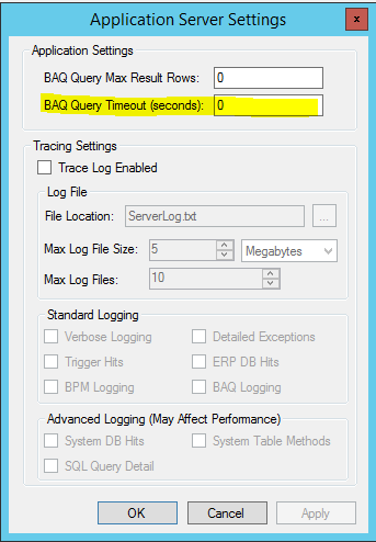

In the Epicor Admin Console which you don’t have access to, there is also a setting regards BAQ execution. I’m not sure what the hierarchy is of how the 2 settings are applied, but it this:
You could raise a ticket and see if they have 30 seconds configured here?
