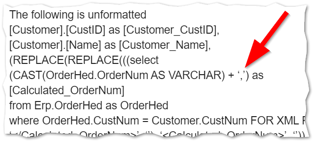

You didn’t just copy and paste from here did you? If a poster doesn’t use the proper method for posting code, single and double quotes get changed to “fancy quotes”
The following is unformatted
[Customer].[CustID] as [Customer_CustID],
[Customer].[Name] as [Customer_Name],
(REPLACE(REPLACE(((select
(CAST(OrderHed.OrderNum AS VARCHAR) + ‘,’) as [Calculated_OrderNum]
from Erp.OrderHed as OrderHed
where OrderHed.CustNum = Customer.CustNum FOR XML PATH(’’))), ‘</Calculated_OrderNum>’, ‘’), ‘<Calculated_OrderNum>’, ‘’)) as [Calculated_Orders]
from Erp.Customer as Customer
and here it is with proper quotes

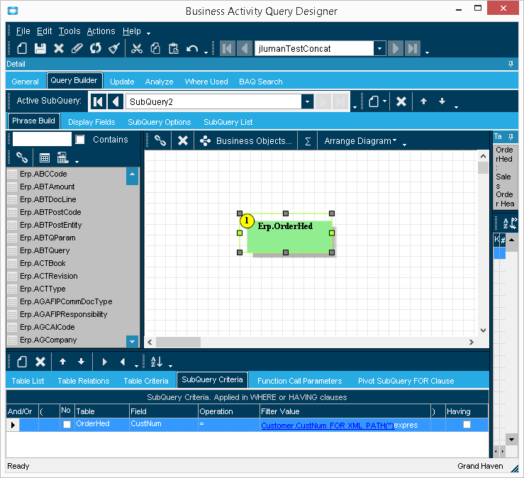

The SubQuery Criteria’s expression should only include tables that are in the subquery.
Your Subquery2 only has OrderHed, while the criteria expression references Customer.CustNum
Try changing that to OrderHed.CustNum

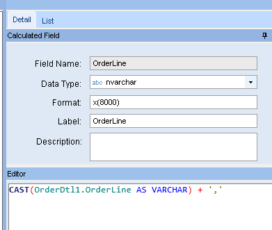

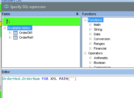

My sub query has a single column returned. A calc field OrderLine with the settings expression:
Note: OrderHed is not a table in this subquery. The subquery uses OrderDtl1 and OrderRel1 (aliases of OrderDtl and OrderRel)

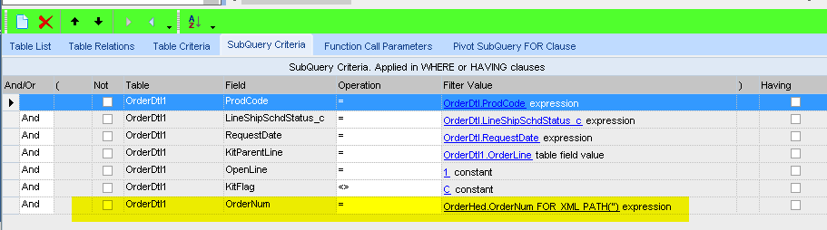

The Sub Query Criteria has several rows, but you only need the last (and it must be the last)
The expression for that Filter Value is:
