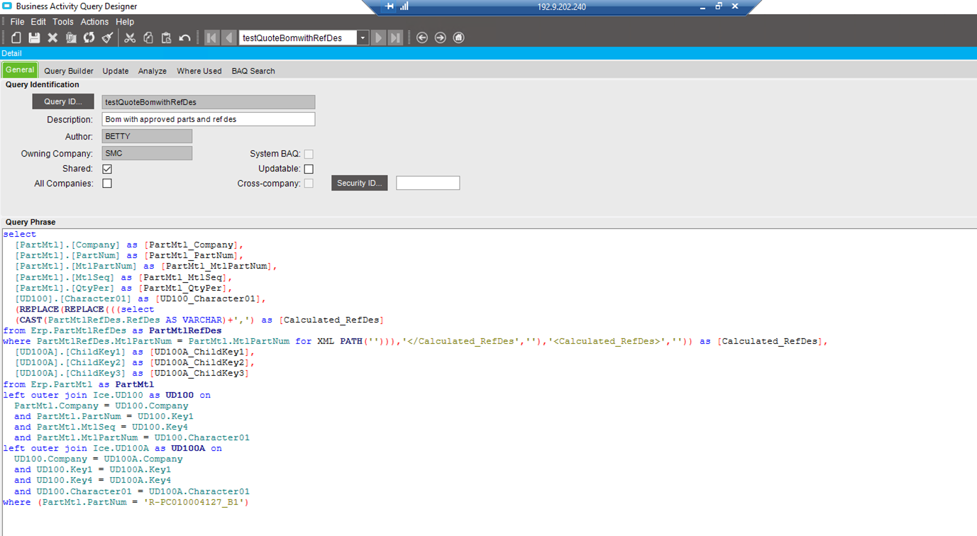

Hi All
Ive been trying to get this to work for sometime, but I cant seem to eliminate erroneous ref designators. Most of them are correct, but several of the Material Part rows are not showing the correct # of ref designators. Im not a technical person so hoping for help in simple terms.

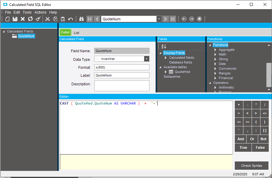

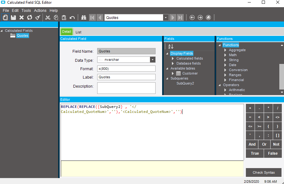

could you screenshot your BAQ calculated field statement ?
Calculated field on Subquery1
Calculated field on Subquery2

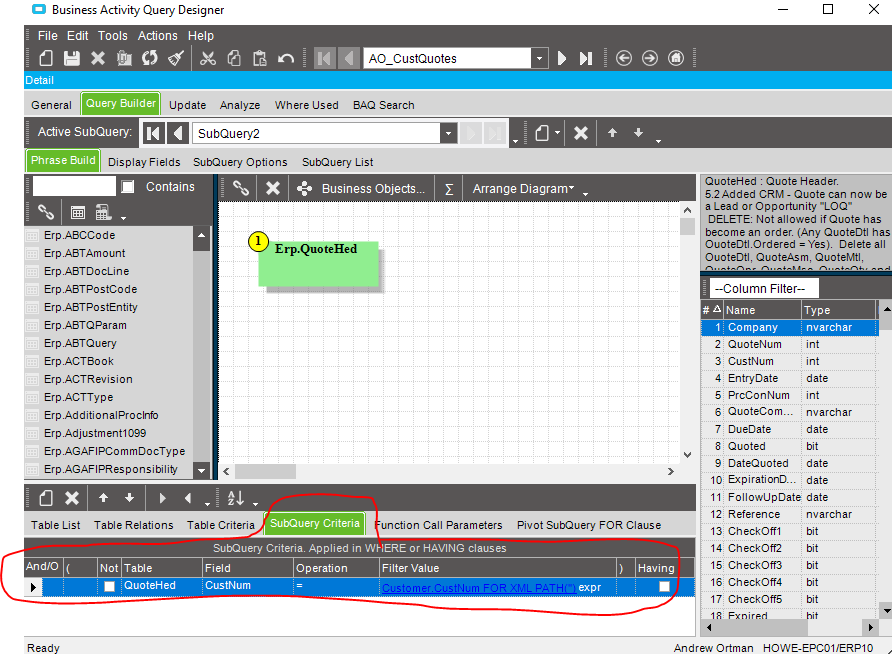

Did you add your subquery 2 to your subquery1 ? QuoteHed table is not shown as available table…Just customer table shows in your list…
No, I used a subquery criteria:
copying same quries as the CustOrders.baq exaple that Jose posted. (Which runs without errors)

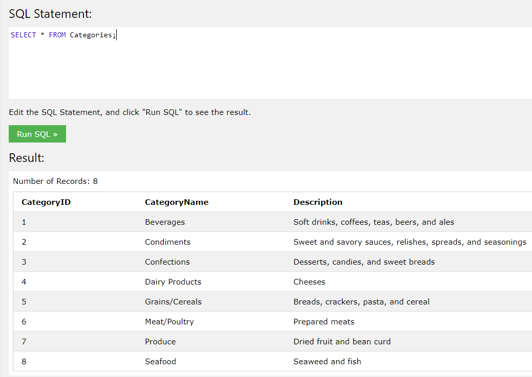

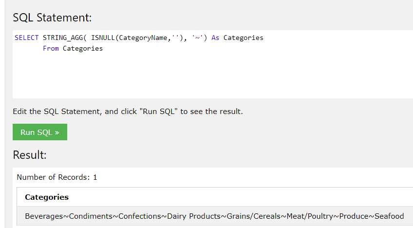

i don’t know why having two subqueries, -did not read the thread from the beginning-, however this is the code i use to concatenate rows values in one single field:
STRING_AGG( ISNULL(QuoteHed.QuoteNum, ' '), '~')
i have tested it this way

yes i know pal, this website i use verify it the same way, just make sure you allow for enough number of characters within the declared string variable, try it and let me know
