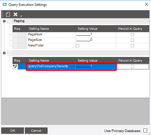

For anyone that’s running 10.2.700+ on a pre-2017 version of SQL, you can still get the “FOR XML PATH” trick to work by adding the query execution setting (in BAQ Designer: Actions->Execution Settings) named queryOldCompanySecurity and set it to 1.
I believe this should work on versions 10.2.700.5+, and you can request a hotfix from Epicor for earlier versions. (See EpicCare technical support bulletin KB0104912)
