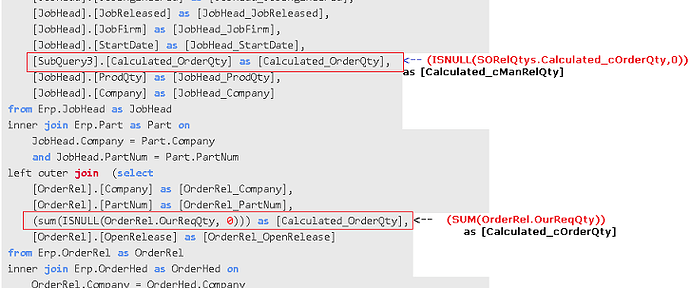

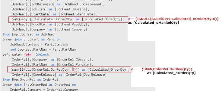

I’m thinking you can use a simple sum in SubQuery3 and use the ISNULL in the the TopLevel query?
i.e. thinking something like this (except the subquery name is “SORelQtys” in this example)
