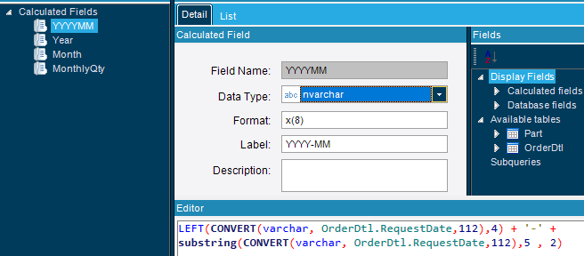

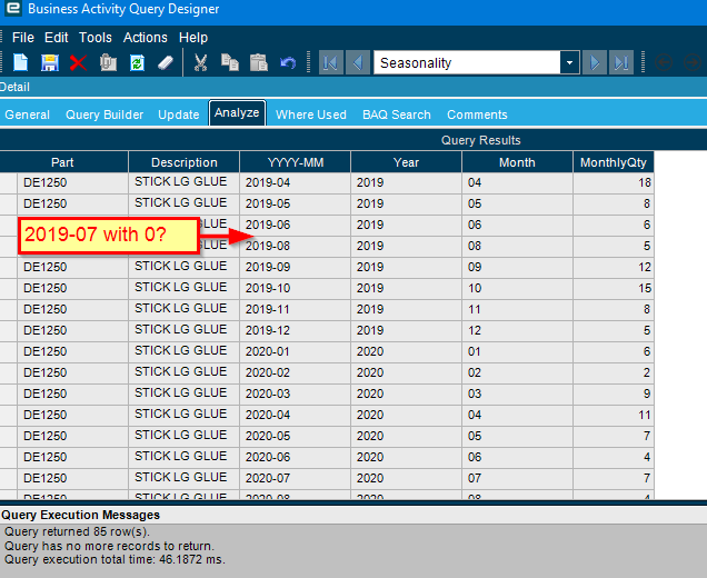

I’m trying to create a table for analyzing part seasonality. I created 2 BAQ calculated fields to group by Year & Month, and another calculated sum to show monthly order qty. I need to include the months with 0’s, rather than having the BAQ’s SUM skip them.
How can I show the null rows?

Still think it might be related to not having any data at all, so there is no row to start with. Maybe it’s due to the other GroupBy’s for the date columns? How would BAQ know to even create the ‘2019-07’ row if there is no order detail with that record to create that calculated field? Jeez, I don’t know where to start with that one! Rabbit holes…

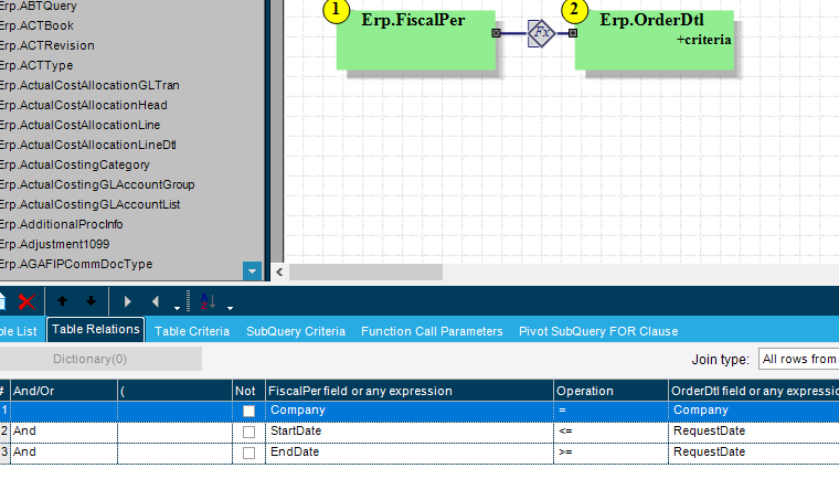

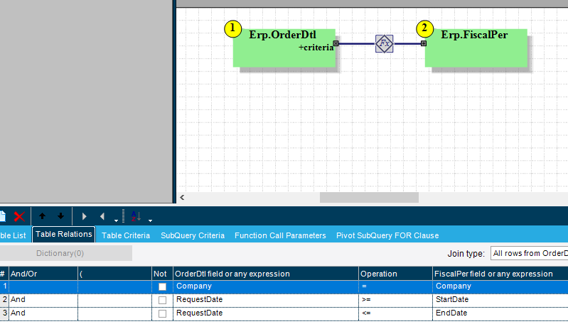

a left join will not magically create a July, you must have an order in July. You could start with the table FiscalPer thats assuming you have 12 periods, for us it wouldn’t work. Maybe Company Calendar or some other table that has Months, otherwise you will have to build one with FOR XML.
Idea 1:
Idea 2:
Idea 3:
MonthlySales from Epicor Demo Database

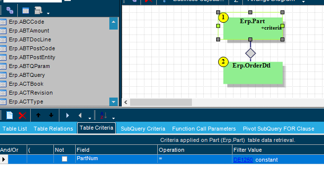

Haso,

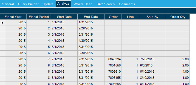

Awesome!!! When I created a new test BAQ by adding Fiscal Calendar first, and then OrderDtl, the missing rows showed up with a left join. TY!
Yet when I try to add Fiscal Calendar 2nd, after OrderDtl, no matter what, the missing rows do not appear, even if I do a full outer join.
Do I need to rebuild the BAQ, making sure to add Fiscal Calendar before OrderDtl? Is there a shortcut way of making that change without needing to delete OrderDtl and re-creating everything associated with it?
Is that a quirk with BAQ’s?
vs (no missing lines):
You can reorder them in Table List (the tab before Table Relations).

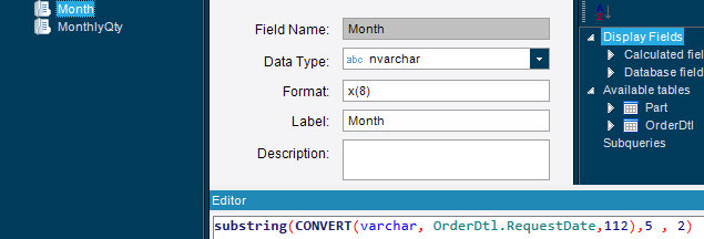

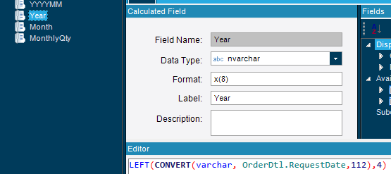

Ooh… don’t call a calculated field “Year” or “Month” or “day.” You’re asking for trouble.
You’re fine to make the description “Year,” but name it TheYear or anything else.
You just made me realize that’s why the BAQ would seemingly just randomly not like my syntax in a calculated field. I’ve made a bad habit of calling calculated fields things like Year, Month, etc. I just learned today that Row is another one that you need to not use.
It’s deceptive because (a) it allows it and (b) it works sometimes. But if you calculate off of a calculated field in the same subquery, for example, it calls it by Row rather than Calculated_Row
And probably many other reasons that are clearer to SQL people.
Without a doubt, that’s why it seemed sporadic. I’m sure sometimes it was referenced within it’s own subquery and other times it wasn’t.
