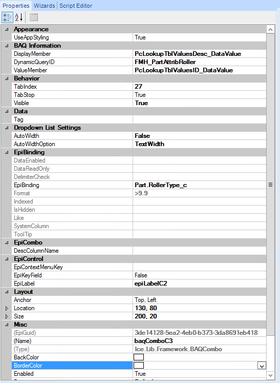

I have three BAQCombo boxes attached to decimal UD fields on Part. The selection works fine–I can select the option and it displays. I save the record and can query the data out.
But when I save, sometimes the combo box goes blank. And when I clear the form and call the part back up, the contents don’t show in the combo boxes. I can save the record and still query out the data. It’s just not showing.
It’s like in the configurator where you have to refresh the combo box before you can store a value there.
The string combo boxes are working fine.
I’ve attached a screen shot of the combo box properties.
Anybody seen something like this? Is there a “refresh” code to be added?
