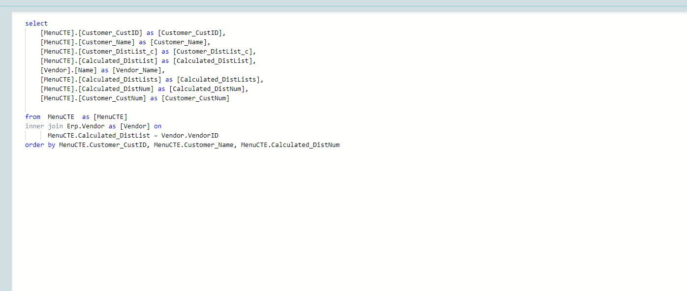

here is my query

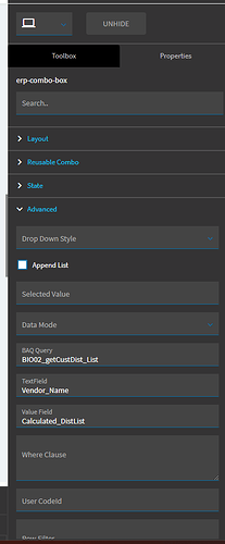

here is the combo box with the BAQ

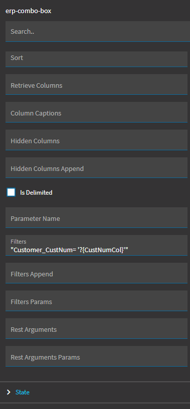

and here is the filter that I have used
