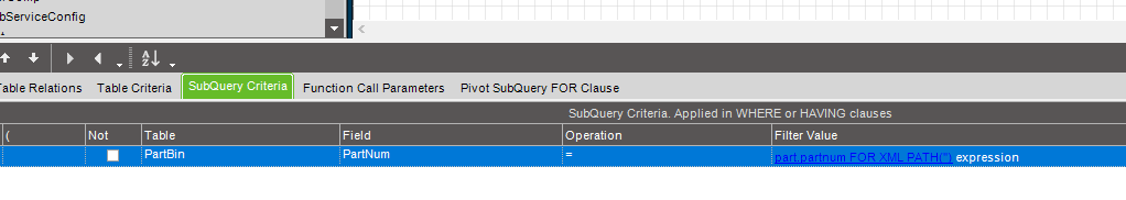

Can you show some screen shots of your subquery criteria? Also, something is messed up in your XML path the results shouldn’t show the <> bracketed items in there.
I think I have screenshots of just about everything. See attachment.
Job Pick List.pdf (272.9 KB)
There are a couple things I see that I think could be the problem.
first, your subquery criteria is saying that PartBin.PartNum = ParBin.PartNum. So it’s not filtering anything because the same field will always equal itself. It should be referencing part.partnum instead. It’s not in the menu to pick because it’s on a different level, you have to type it in.

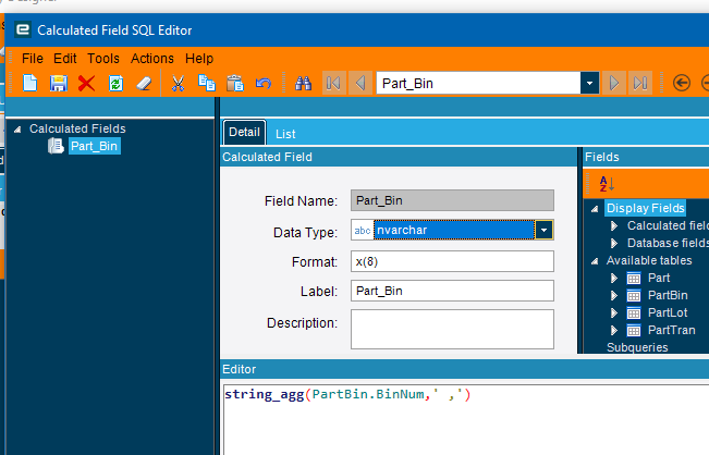

Also, what version of SQL are you on? If you’re on 2019+ you can use the String_Agg() function to do this a lot easier.

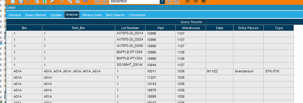

Here it is, thanks.
stedertest.baq (25.9 KB)
You’re missing the whole subquery to concatenate the rows.
if your SQL version is 2019+ then try this as a calculated field
string_agg(PartBin.BinNum, ' ,');
and group by the other fields in the query.
