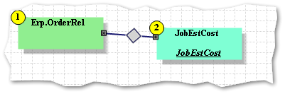

  • The Top level sub-query
    • with table Relations:
With no table or sub-query criteria set anywhere, it runs full out.
If I set a table criteria like OrderRel.OrderNum = 2200240 It only returns the rows for Order 2200240.
But did it have to process the ISQ query for all Jobs?
If I add another table criteria, this time in the ISQ, of
JobHead.JobNum LIKE convert(varchar, 2200240)+'%'
The ISQ only runs for a subset of jobs (ones beginning with '2200240')
I assume this is much faster than when the ISQ computes the cost for Every Job, but then only provides the ones with the table relationship specified in the Top Level
My main concern is that if this is to be used in a BAQ or embedded dashboard, It won’t have those table criteria. Would the BAQ run full out, and then only return the records based on the Dasboard’s filter/criteria?
