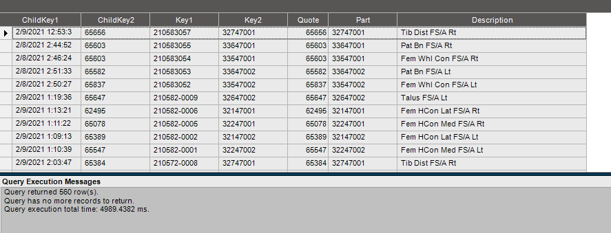

I’ve noticed recently on my 10.2.600.5 instance some very odd and poor performance on BAQs with seemingly innocuous things.
For example, take this query.
If I include the table restraint on Part.ShortChar01, the query times out and will not run.
If I exclude it, the query runs in under 5 seconds.
I had a different query that timed out if I put date parameters on the InvoiceDate field. Running the query WIDE open in a dashboard to return 30K+ rows takes a couple seconds. But if I add a start and end date parameter, it refuses to run.
Any ideas? Both of the same queries run almost instantly in SQL as written.

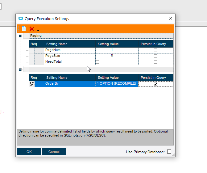

That’s likely because you have a bad cache on your Query Plan. Try adding OPTION (RECOMPILE) to your query.
This isn’t trivial to do but if you go to
Then add Order By 1 OPTION (RECOMPILE) persist in query
That may fix it, give it a shot.
Well, shoot. I don’t know what that means, but changing that makes it not run at all, without any table constraint

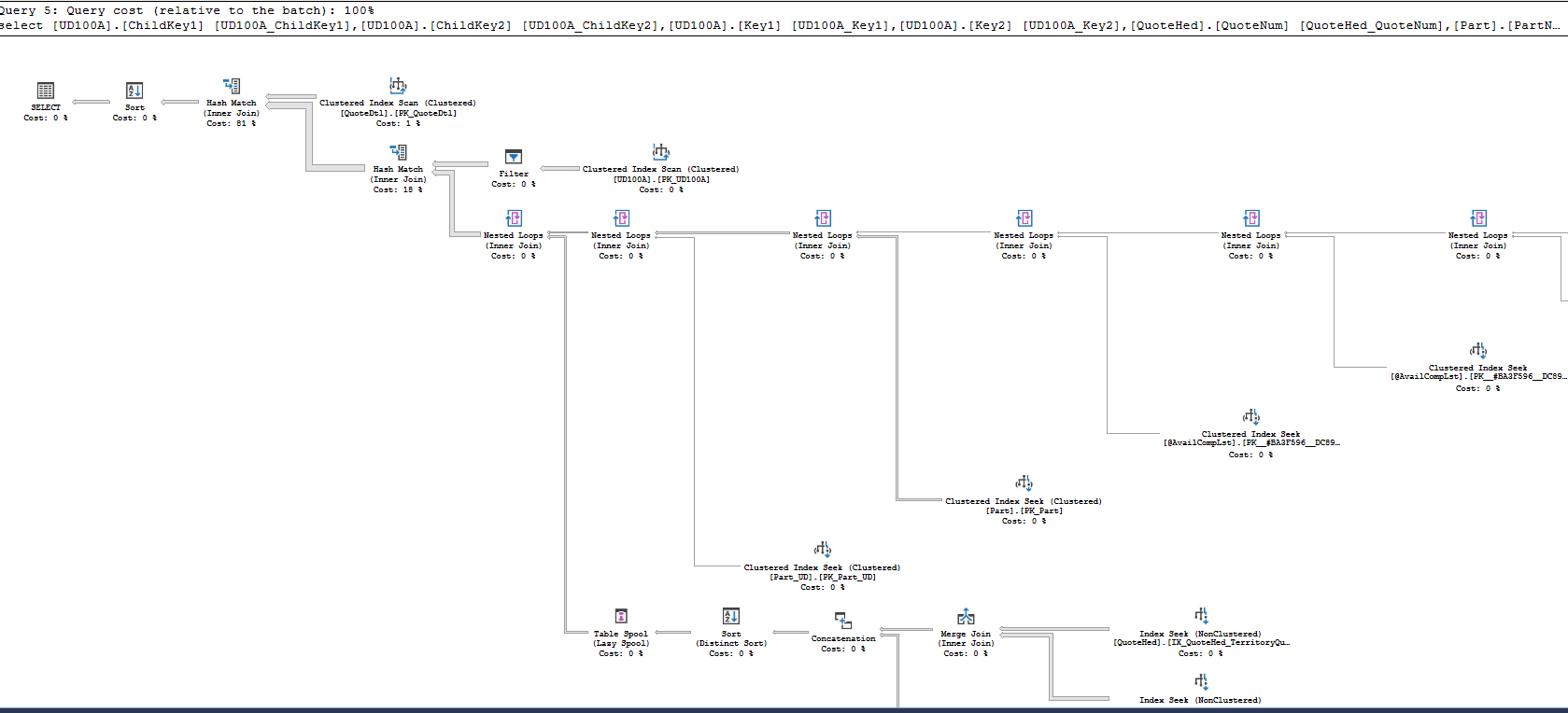

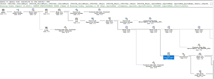

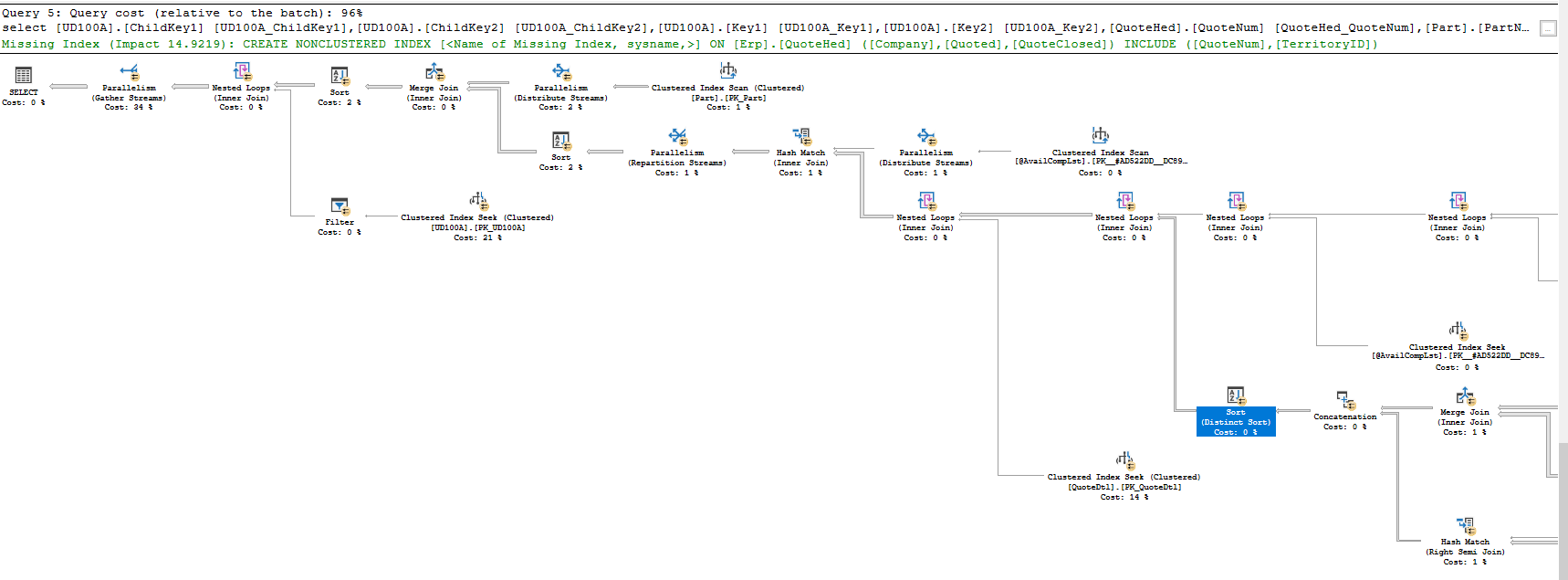

Look at the query plan, you can download it from Actions
Should I try that with the constraint on the table or without?
Well, I did both and surprise surprise, I have no idea what I’m looking at here. In the execution plan where I applied the table constraint (and thus the query didn’t run), it looks slightly different than the execution plan where I removed the table constraint (and thus did run).
Without knowing how to read this, it looks like everything in the “table constrained” query get hung up on something called a Hash Match? I don’t know what I’m looking at though.
Constrained (doesn’t run):
Non-Constrained (runs great):
Other than that, it seems to always want a new non clustered index, but that’s probably expected

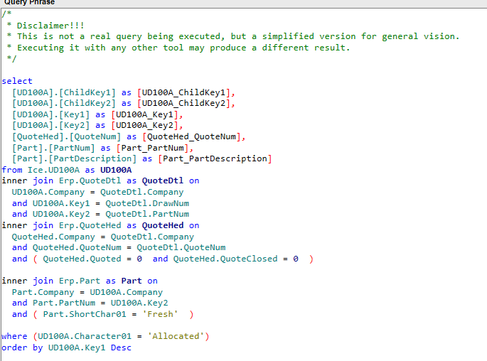

What if you put your QuoteHed.Quoted=0, QuoteHed.QuoteClosed=0 and Part.ShortChar01=‘Fresh’ as table criteria instead of in the joins?
Also, you might want to look at adding an index on the Part.ShortChar01 if you use it a lot.
They are actually not in the joins, but are in fact table criteria, it looks like the sql it writes does make it look different
If you add it as a table criteria, it will show up as a join condition. To have the criteria in the where clause, you need to use the SubqueryCriteria.
Part.ShortChar01 is not a real Part field, it is UD field and when you add criteria on it, BAQ secretly adds join on Part_UD. Looks like search in Join for that UD is not effective. Try to move it out, to Where clause for example.
In my example the criteria is added on the table criteria (where clause, id assume?) but the syntax in the baq makes it look like it’s a join criteria. Since the baq presents views as table objects to interact, it shouldn’t matter I’d think?

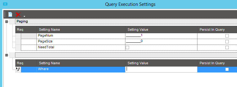

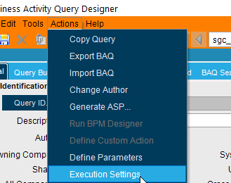

@Aaron_Moreng I would try what @Olga suggested and move those specific criteria out of the BAQ and into the Query Execution Settings. It should definitely improve the performance.

It is another way around - you think it is in Where, but it is actually in Join. This was done for compatibility with E9 when we moved to E10.
Subquery Where should be used if I remember correctly to have a real Where clause. Or even in query execution settings, as suggested by @John_Mitchell, then filtering will be done at the very end. Try both.

Execution settings are applied after main query is executed. This runs main query as subquery and then its result is filtered. Normally, we don’t use it ordinary BAQ execution, but more in additional filtering, required for example in dashboards.
