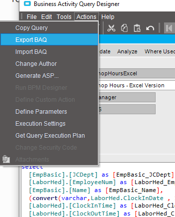

Hello, is it possible to export the BAQ like the data directive(bpm files)?
In the Actions menu:
Thank you very much! I was expecting a different windows that performs that! :slight_smile:
