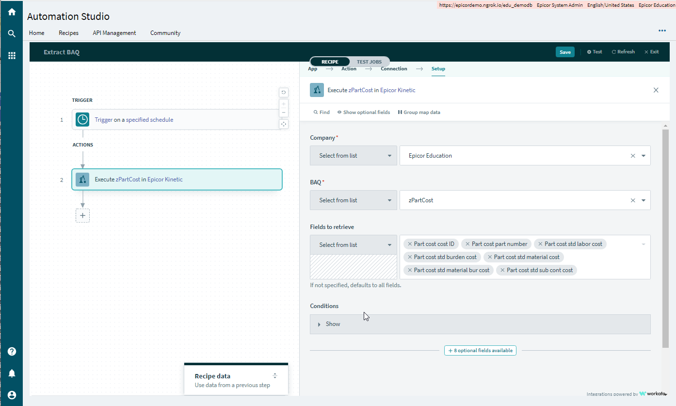

Similar to what @Mark_Wonsil suggested, you can also use the new Epicor Automation Studio to run a BAQ, and then do anything you want to with the data that comes from the BAQ. But with Automation Studio, you don’t need to understand how to run a BAQSvc from REST… it is a built in component within Automation Studio and takes no-code. I just built this example in the last 3 minutes:
