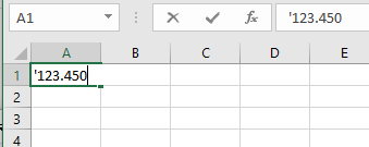

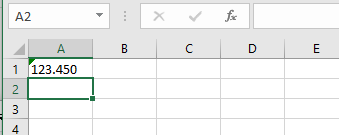

If you’re manually typing a string of numbers into Excel, you can start the cell with a single apostrophe ' like:
When I hit enter it will retain the fact that it is text and doesn’t lose that last character.
And the Length of that cell is 7. Not the 8 that it would be if you include the leading '

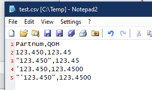

However, adding that to the CSV data like in lines 4 or 5 below:
yields:
While they did remain as text, they now have an extra character. And the length of either of those two yields 8

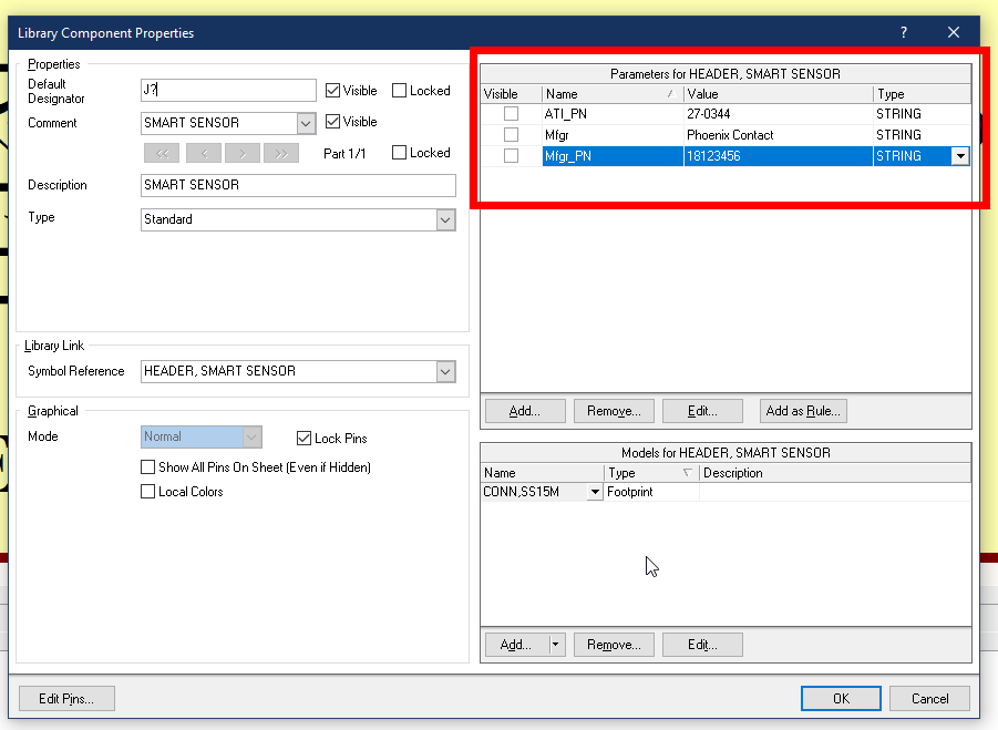

Just when I think I’m out of the woods… engineering wants to link Altium to the DB to download our internal part numbers along with the associated manufacturer’s part numbers. IT doesn’t want to give engineering a profile to connect to the SQL database directly…I just want everyone to have the data they need… Does anyone have any experience with Altium? I feel like exporting as an XML file is easier in terms of keeping the data consistent but I don’t know if it’s possible for them to then link to it as a datasource.
I use Altium daily. Although it’s a probably a much older version.
I’m guessing they want to fill properties of schematic components/libraries
I wouldn’t think this would be something you’d link to the Epicor DB. Maybe just pull in once when the part/library is created. And maybe occasionally when the E10 DB changes and that Altium part needs to be updated.
I’d personally be hesitant to let my Altium files be automatically updated when the Epicor DB changes. Things could go bad real bad, real fast.
As far as giving users select data from Epicor DB, you can create data connections that only return the data specified by the connection.

Engineering likes to keep their library updated with all of our internal p/n’s and MPN so that when they are designing a board they can export the BOM with our p/n’s and it makes it easier for everyone.
